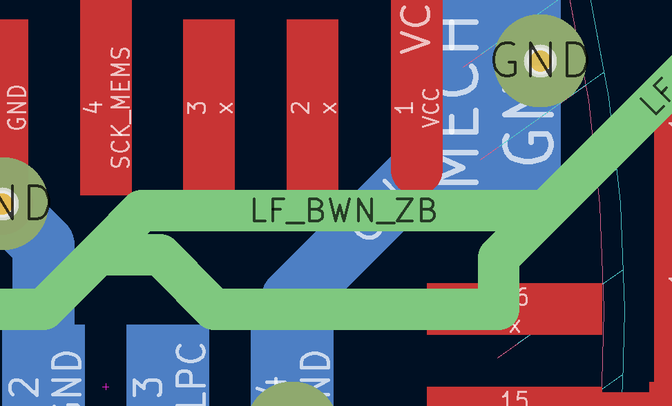

i’m placing multiple vias to increase current capabilities of a connection:
the mechanism of removal of redundant tracks seems that is stronger than the locking flag on the tracks, no matter if i start connecting and locking from top or bottom, i always end up with 1 via unconnected on top or bottom:
is this something new? there is a way to avoid this behavior?

Totally disagree! When you deactivate this, you globally end up with tracks looking like that:
This is explicitly useful when you draw an alternative way of an existing track where you WANT to remove the redundant track part!

No, with the option on, the existing/old track path gets deleted while routing/completing the alternative path.
This screenshot is the result, when the option is switched off.
