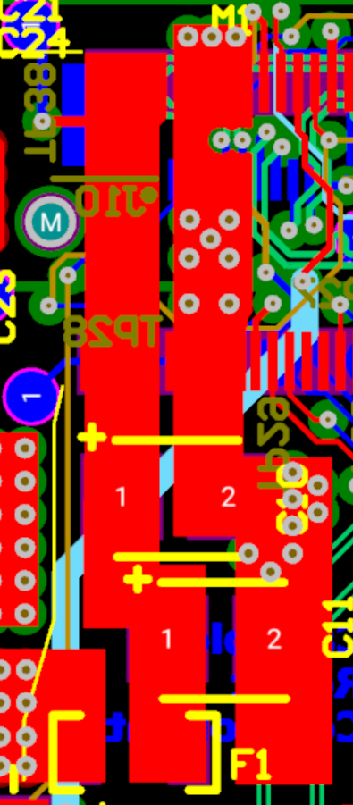

Hello, I am designing a pcb which uses 260 pin connector which looks like the below picture
I want to draw rectangular trace like in the corner for VCC and GND pin like the below picture(Altium project). Any one can help how can I achieve this ?
Thanks
Abhishek
What you are after is FILLED ZONES.
https://www.wayneandlayne.com/blog/2013/02/26/kicad-tutorial-copper-pours-fills/
