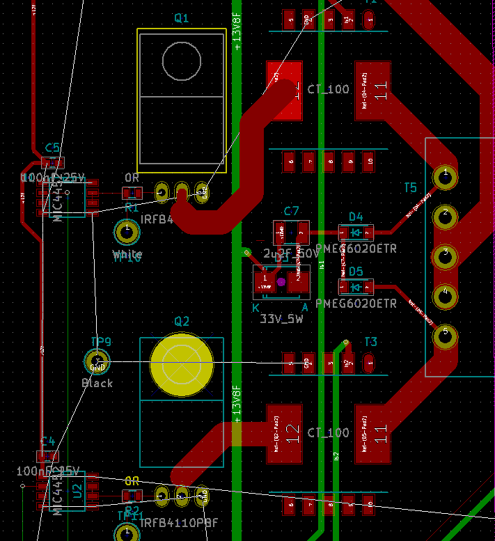

I am still trying this, I hope someone with more experience can give me some guidance. It falls somewhere between my understanding of Kicad and of how PCBs are made! The attached screen shot shows (I hope) what I am trying to achieve.
I did my layout with a TO-220 with a big hole (8mm) (this is like Q2). But I still have my doubts about assembling the board and power transistors onto the heat sink. So I created a footprint with no hole, and added a rectangular edge cut where I want the part to be. This is Q1. Is this going to cause a problem for a PCB house? The cut-out is shown with sharp corners- how is the cut-out done? Do I need to specify a radius, such as for a router bit? I realize this is going to increase the cost of my board, but the alternatives are also ugly- having the components all in the clear, and then long traces to where they need to go. Could even necessitate splitting into multiple PCBs. I am trying to keep lead inductance and resistance low by putting the parts where they need to go.

Some board houses use a 2.54mm router bit (e.g. oshpark), others 1mm or 0.8mm. That will determine the radius of the cutout’s corners. Unless you want to add a huge safety margin there, I suggest you ask for that number.
You can specify a radius (draw arcs), but it only is worth the effort if it is larger than the actual routing bit. If you don’t specify anything, the fab will usually route to the center of the line and you’ll get a corner radius corresponding to the bit in use.

In the pic up there your silkscreen looks normal… are you referring to the values/references of the components?
They look ‘invisible’ to me…
Clean the mouse pointer from any tool selection, then draw a selection rectangle over everything you want to move… in the upcoming dialog deselect everything except ‘Include board outline layer’… then move this ‘group’ where you want it :wink:
