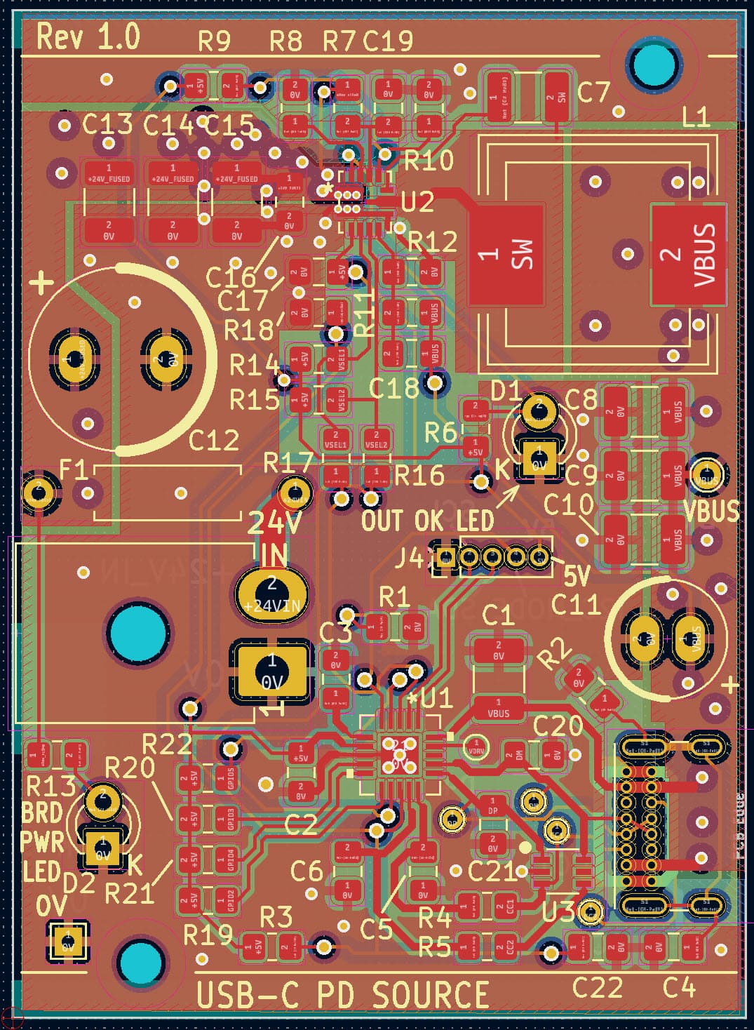

Fast-forward to almost a year later, and I’m comfortable using KiCad for 4-layer boards with a fair amount of control:
100W USB Type-C Power Delivery Source: Getting Started

Is your one fix U1’s pin-1 flying? :slight_smile:

Hehe no, U1 pin 1 is connected (it is connected with the track coming off perpendicular to the pin, up to C1).
The bodge was that the I2C pull-up resistors were going to the wrong rail, so it involved cutting a trace on the underside and adding the wire to the correct voltage.
