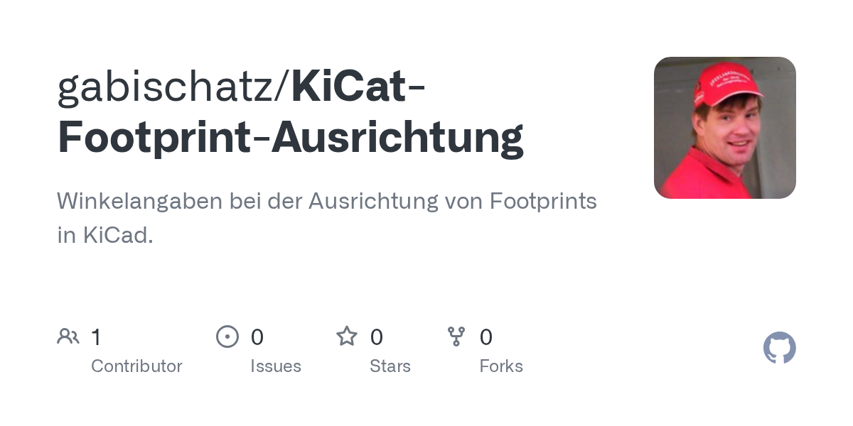

Hello, I’m not really familiar with coordinate systems, especially not in the KiCad circuit board editor.
Is this correct as I drew it and is the caption correct?
Maybe you want to read Coordinate system, grid and origins in the PCB Editor first.
Yes I read that. I would like to make a description of how to precisely align a component in the pcb.
These are the pictures I created for it. All I know is that the coordinate system starts at 0° on the right and
ends at 180° on the left. Above are the positive angles and below are the negative ones.
As far as angle display is concerned, I’ve observed that the arc tool uses [0,360) but the dimension tool uses (-180,180]. Which probably makes sense in the former case, since negative arcs aren’t much use, and arcs like 270° are useful.
The FAQ article tells that the default coordinate system of the PCB editor starts from the upper left, and Y grows (positive) downwards. I’m not sure what your quadrants describe.
Yes, thanks.
The title is a bit misleading as I assumed it had something to do with the coordinate system. But it is only indirectly so. I now have the help ready so far.
I would be happy if you check out the eng. can check google translation.
