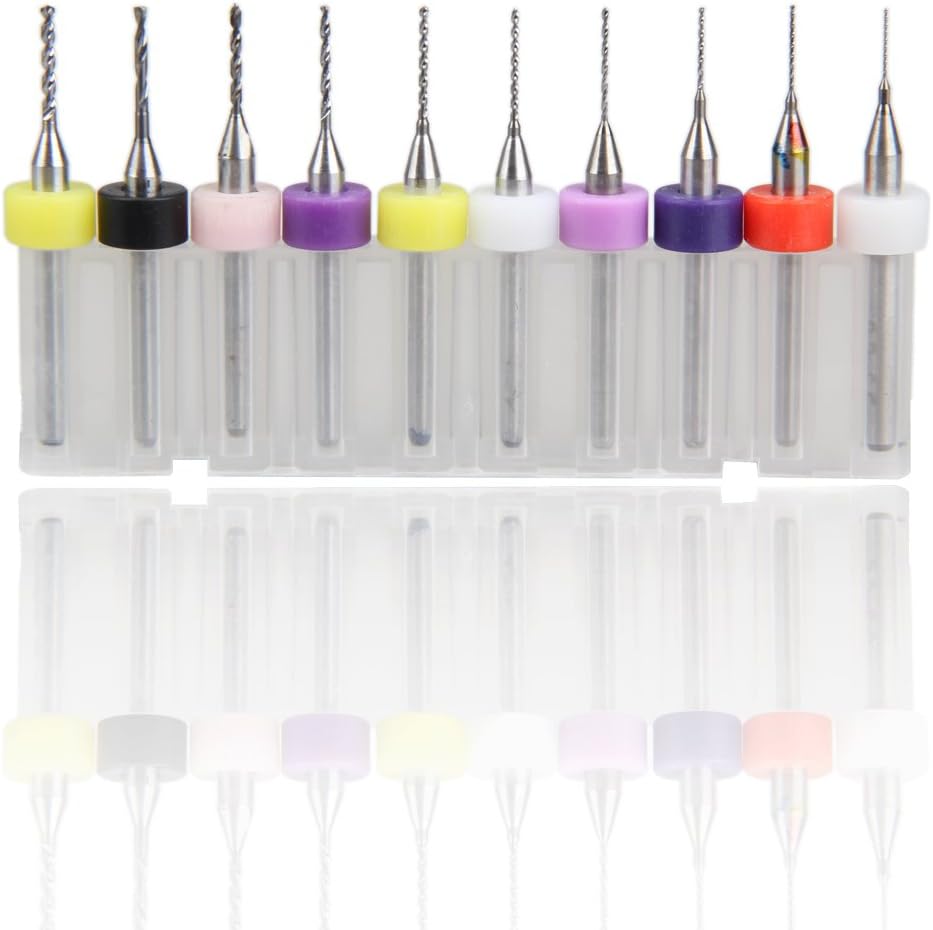

I think you need to look at your drilling procedure? Do you etch or drill first? When you say hand drill do you mean free hand or drill press? Are you using hardware store bits?
Probably. Over the years we have changed/improved our fabrication procedures mostly abandoning the UV-exposing process in favor of toner-transfer techniques. But drilling remained essentially the same.
Etching first.
We have a drill press in our lab. It does a fairly good job, but it’s not a tool specifically designed for drilling PCB. A CNC drilling machine is out of budget.
Yes. Any advice on that?
You should use sharp carbide bits. Something similar to these:
You can find them all over the place, I just grabbed the top non-ad google search for “pcb drill bit”. Many of the electronics vendors like DigiKey, I think SparkFun and/or Adafruit carry them, and I’d be surprised if you couldn’t find them on E-Bay. When shopping for the best price, look for the “re-sharps”. Those are bits that have been sharpened but no longer match the tolerance of the manufacturers. They should be “close enough” for the home-gamer though.
EDIT: FYI, these types of bits are made for high-speed drills (2k-3k rpm range). Standard drill presses aren’t fast enough. But a dremmel-style rotary tool with a drill-press attachment should work a treat.

(Note on footprints for hand-drilling: Manual drilling works best when you etch away a little dimple at the center of the copper pad. This creates both a visual target and a mechanical guide for the drill bit to align with. KiCAD doesn’t have the ability to create this pad style automatically (unless it slipped into version 5 when I wasn’t looking) but it’s a feature you can incorporate into your custom footprint library. More discussion at Enable drill marks for Gerber files .)
Ordinary twist drills from the hardware store are not good choices for PCB work. The standard tip geometry does not make clean entry or exit holes, and the fiberglass PCB material dulls the drills quickly. The carbide bits mentioned by @SembazuruCDE are a better choice. You probably know that half a dozen sizes will cover about 99% of the holes you need, and you will design your custom footprints around those sizes. Their major disadvantage is that they break easily, so keep plenty of spares on hand.
To minimize broken drill bits you should also pay attention to runout (slop) and eccentricity (wobble) of the chuck holding the bit. I don’t know a particular make and model to suggest, but I DO know that Dremel-style hobby tools come in several models and grades, and bearing quality is often the major difference.
