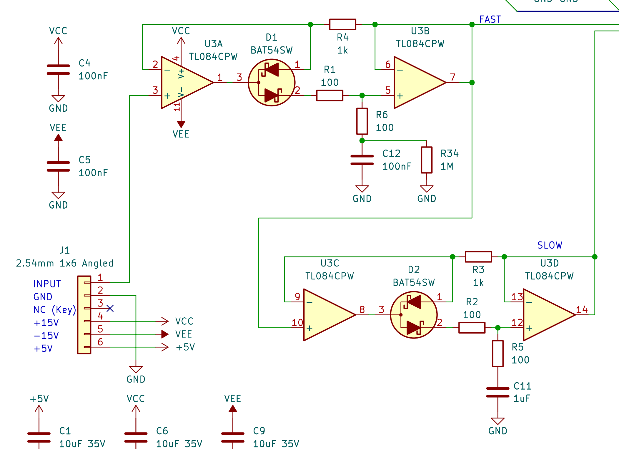

Made using 129 ICs and over 1200 components in total this massive project delivers a stunning-looking audio spectroscope without any microcontrollers or other digital signal processors.
Theory of operation:
The device consists of 11 PCBs, one backplane and 10 display modules. On the backplane there are 2 3.5mm TRS sockets. Both of them are connected together, and the user can plug the source to one of the sockets, and headphones or speakers to the other, so there’s no need to use a splitter. Next using a set of jumpers (JP1, JP2, JP3) the user can use either the left, right or both channels as the input for the spectroscope. Jumpers feed into a preamp with user-adjustable gain (U4A), so both quitet and loud listeners can see the spectroscope work. The series shottky diode (D4) protects the preamp from voltage spikes coming from the audio input.
The preamp feeds into 10 active band-pass filters that separate the audio signals into different bands. Those bands are: 32Hz, 63Hz, 125Hz, 250Hz, 500Hz, 1kHz, 2kHz, 4kHz, 8kHz and 16kHz. Each band is connected to a separate display module connector.
Each display module has two peak detectors connected in series. The first detector made up of U3A, D1 and U3B has a smaller hold capacitor C12 and it’s quickly discharged by R34. Output of this peak detector will show the current amplitude of a filtered audio signal. Next peak detector (U3C, D2 U3D) has a larger hold capacitor and it does not have a discharge resistor. Since it’s connected to U3D and D2 it will still discharge, because of non-zero leakage currents of those components. Output of this slow peak detector will show the maximum amplitude of the audio signal and hold it there for a short while.

I think this is a great use of this category, and clearly lots of work went into it :brain: cheers.
:mouse:
:clap: :clap: :clap:
“My favorite programming language is … solder” (Bob Pease)
it’s very nice, it’s how we would have done it in 1970,1980,1990
demonstrates understanding of analog techniques.
