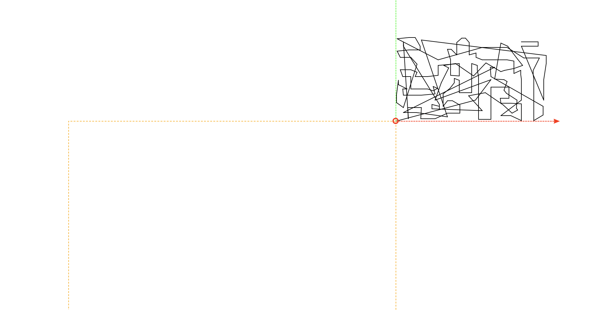

From this I can make changes in pcbnew and just rerun and 2 seconds later I have bCNC open with the changes loaded, ready to send to the cnc. However, I’m having problems with offset, the gcode I get looks like this:
I can find no setting in pcb2gcode to input any offset in the generation from drl to gcode. I’ve tried just setting the “origin point for drill and place files” but that doesn’t even make difference. This is my pcb in kicad:
It looks to me that origin is still on top left of the A4 or whatever that is… I’m not sure where the best in the pipe to fix this or where to investigate…

Two seconds later I find this:
–zero-start
set the starting point of the project at (0,0). With this option, the projet will be between (0,0) and (max_x_value, max_y_value) (positive values)
Not sure I understand that text, but it seem to be doing something decently to what I want (maybe):
Use also need to enable “Use auxiliary axis as origin” when generating gerbers and “Drill origin : auxiliary axis” when generating drill file.

Good question, you can get the aux origin with board.GetAuxOrigin(), and there appears to be a property of EXCELLON_WRITER that is the offset, I’m not sure of the right Python syntax to access that, but maybe
drlwriter.m_Offset = board.GetAuxOrigin()
Awesome, thx!
# drlwriter.SetOptions(mirror, minimalHeader, offset, mergeNPTH)
drlwriter.SetOptions(mirror, minimalHeader, board.GetAuxOrigin(), mergeNPTH)
