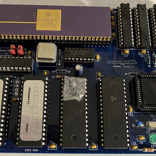

Same issue here. Busses are too much trouble. Since each wire needs a label anyway, just use a global label for each wire connection on your “bus”, like DRAM_ADR0, DRAM_ADR1 etc directy to the pin (no wire, no connector, just a label on the pin on each side), and be done with it. Global labels works and are easy to understand and reason about, unlike busses which nobody seems to be able to figure out. After trying everything and then some, the bus I was trying to make always said it has “no members” and never resulted in a connection - many hours wasted.
Well, apparently it can be done. As those people before you in 2017 had success, and I’ve also done it myself.
See for example this project (also on github)
I helped a bit there with the initial conversion from eagle → KiCad.
But syntax is finicky. Note for example that ydohi uses three dots, while it should be two.
