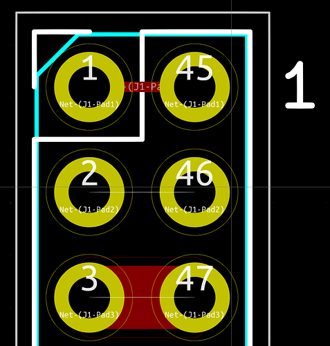

I think the attachment should express my problem. I have a somewhat complicated connector consisting of 2 double rails and each pair is interconnected in its footprint with copper. It has a complimentary eschema representation with the appropriate connections.
For some reason when I run DRC-
  1. the Ratsnest does not recognize the existing connections
  2. the interconnections get marked as “too close”
I don’t see why these problems.
Any ideas appreciated
cheers
Fritztemp2.zip (59.2 KB)

The problem is in the way you (ab)use the pads in your footprint.
It simply does not work that way in KiCad.
You get DRC errors for THT pads overlapping with SMT pads (which have no pin number, so you can not use them normally in KiCad.
Your options are (sort of):
  1. Ignore the DRC and ratsnest errors.
  2. Remove all SMT pads from the footprint itself, and draw copper tracks in Pcbnew.
  3. Give all overlapping pads in the footprint the same pad number.
  4. Replace the SMT pads with “polygons” on the copper layer.
Comment:
  1. May be acceptable if it’s just a simple test jig, not recommended if you want to add more stuff.
  2. This option uses the schematic & netlist to make your connections, it’s the “normal / recommended” way.
  3. This is used quite often in KiCad’s default libraries. For example for thermal via’s (Study those footprints as example).
  4. Is used in “Net-Ties”. This does get rid of the “Pad too close to pad” errors, but not of the Ratsnest. The way this is used in the Net-Ties is a (temporary) hack (hopefully improved in some future KiCad version) You still have to draw real copper tracks for the connections, which brings you back to 2).

I’m not completely sure of your intentions.
My best interpretation is that you want the connections to be a part of the footprint, so it can be used in other projects.
The best workflow for this is option 3). This is not a “workaround” but normal workflow in KiCad. KiCad does have a (very logical) limitation that pads in a footprint adhere to normal clearance rules, and pads too close to each other are therefore DRC violations.
A built in exception is that pads with the same pad number are treated as a single pad in KiCad.
If two pads in a single Footprint have the same pad number, then both pads will be added to the netlist, and you must manually connect them on the PCB.
If you have overlapping pads with the same pad number, then KiCad recognizes this and treats it as a single pad with a complicated form.
Again: This is not a “workaround”, but normal work flow in KiCad.
What you have made is unusual, and does not fit within KiCad’s workflow. You must choose between using separate pads and then use the schematic and netlist to draw the connections on the PCB. Or you make the connections in the footprint itself, and in that case you do not have to make the schematic at all, but it has the limitation that pad numbers must match.

This is one of the weirdest thing I have seen. You have one symbol which looks like four symbols, and for it one footprint which looks like two footprints. And you want permanent connections between pins.
(The symbol’s visible parts are offset far from the center of the symbol, normally the visible parts should be centered around the origin or touch it.)
Because me too can’t see your intention clearly, I ask from the beginning. Do you need a footprint which
  • you can reuse between boards,
  • has two parts which are always in the same relative locations, i.e. 40.64 mm apart from each other (center to center),
  • each of the two parts is like a normal 0.1 inch pin header
  • and each through hole pair is always connected?
Paul, your point numbering 1…8 is confusing, I think you intended to have 1…4 and the corresponding comments 1…4.
eelik
your description of my intention is the exact thing that I need. This is my own design to port the 44 pins of a PIC to upper boards that carry various utilities using the PIC signals. I think most microprocessor eval boards do something similar–TI, Atmel etc.
I used to just use two separate 2x22 headers, spaced by 40.64mm (1.6"). But when I move one header slightly the other does not move and the system no longer aligns with the further boards. So I want to gang the two 2x22 headers together so they stay fixed. When I design a utility board that attaches then I use the same footprint.

If it’s really the case that the connection between each pair is always there without exception – and it sounds like it is – I recommend number 3 from Paul’s list. You don’t really need the numbers 45…88. One double row connector, for example Conn_02x22_Counter_Clockwise, is enough, but you can modify it graphically to resemble the physical shape better.
In the footprint you would have for example
instead of the 1/45 pair. It can be done also with two pads, oval and circular:
OK–now I understand. I made up a new connector and it works fine.
