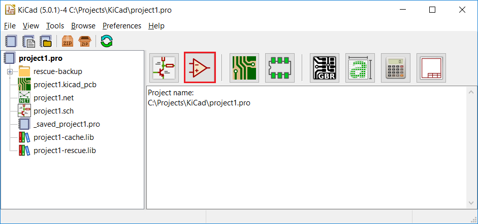

What version of KiCad are you using? If you are on KiCad 5.x have you followed the instructions on SamacSys’s website here:
I quickly reviewed the instructions and don’t notice anything that is obviously amiss…
