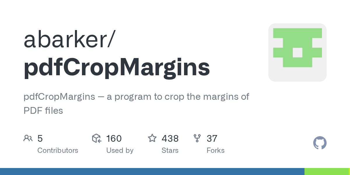

It may also be possible using a tool called pdfCropMargins.
Until this feature is developed, it seems like pdfCropMargins can save you a lot of trouble. It seems to be avaiable both as command line and as a GUI application.
pdfCropMargins does indeed look very worthwhile to know about, and not just for my immediate tasks. Thanks for pointing it out!

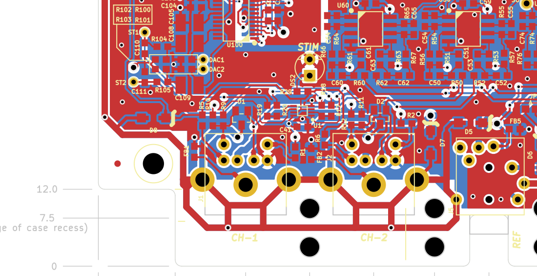

I generate multi-layer pdfs, including user layers (6.0.9, 6.0.10 on linux; dunno about v5). It is an easy selection of check boxes and then print-to-file. Resolution is not a problem:
It is gerber/exc for fab of course, but I like to have a pdf of each copper layer, silk, and fab, but I also have user layers with other data. I also find a top-plus-bottom layer handy at times when I want to follow a signal as I am working on a board, so there are various use cases for multi-layer output. I have never used plot, only output to pdf.

I like to also save pdfs of my fab layers, plus a few multiple-layer pdfs. The pics above are of a pdf I printed from the pcb editor. I opened it into inkscape to magnify it. Generated the pdf from File/Print like this:
Scale to x1.5 just to be bigger on the printer, but I believe any scale would be a decent resolution. Here it is blown up to where the resolution is noticeable:
and forgot to show the last dialog, where the pdf file output occurs. As @ paulvdh pointed out, it is the os that provides a “printer driver” that saves to pdf, and this is it on pop-os:

So your process uses Kicad’s Print (not Plot) feature, and then in your version of Linux the Print-to-file → output format PDF negotiates a higher resolution PDF file than my parallel process does on Windows.
On Windows (10) the Print dialog does have “Print to File” but doesn’t intrinsically know about PDF per se, only offering you a list of “printers”, where one or more may be for PDF output (eg: Microsoft Print To PDF, or, in my case, also Foxit Phantom PDF printer). Evidently the ensuing negotiation produces lower-resolution results.
