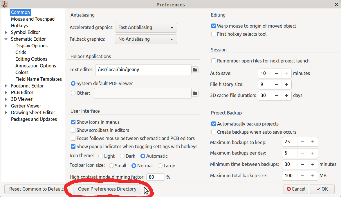

The kicad settings are stored in: c:\Users\your_login_username\AppData\Roaming\kicad\8.0\
Note that the Appdata folder is a hidden and/or system folder (at least my filemanager shows that folder as “special”).
Not sure about v8, but at least kicad v9 presents a button “open preferences directory” in the global preferences dialog.
Yes, Also in V8.0.9 (Which is what I am still using).
On my Linux box, 7 of the files in KiCad’s configuration directory have today’s “modified” date. So if you change those preferences in one project, the others probably have those same settings.
That is the missing piece. I brought that directory over from the Windows machine that was the “source” for the new machine, and the settings are back.
In the Windows File Explorer, when you click the “Open Preferences Directory” button, it shows the users account in C:\Users\ but the displayed path just starts with the users name. It does not show the “full pathname”. Not a biggie, a 100 mS brain delay for me.
So to copy a working KiCad system on one Windows 11 machine to a new one, after installing KiCad you need to bring over your libraries (for me it was schematic symbols, foot prints, and 3D models) and the add their paths in the “Preferences” section.
Then, use the “Open Preferences Directory” (as paulvdh was kind enough to show) and bring over that directory in the path shown. I also just re-named the final “8.0” directory in case I wanted to go back to the “new > V6” defaults.
