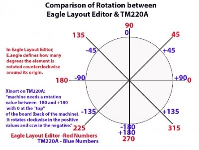

The TMC220 P&P you posted a pic of earlier, not only has a different zero angle, it doesn’t even rotate the same direction Normally +ve angle = counter-clockwise, they have +ve = clockwise.
From http://dangerousprototypes.com/forum/viewtopic.php?f=68&t=5214&sid=bc99cd4efcc494ad48bb9fe2030104dd
KiCad angles are the same as Eagle.
So you are thinking, this is all a mess, what do I do?
  1. Design your KiCad footprints to a consistent standard
  2. Export the pos file
  3. With a script (or even by hand), convert the angles to whatever is required for the P&P machine, and the exact manufacturer, part number (and date) you wish to use
  4. Do a test run, and check it is correct (visually or automated)
If you change P&P, component manufacturer, or part number, you will have to review 3). In some cases, you may need a complete change. At least you know that the angles coming out of KiCad are known and consistent.
