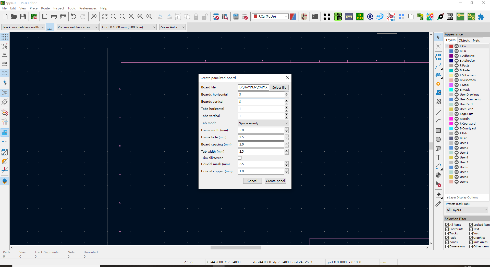

Plugin:panelize
@hayden, does not work for this test PCB (tmp.7z (4.5 KB)) , could you try at your PC?

The original version of this plugin does not currently support kicad5.99. The one I used is modified from the original version and has some bugs
Could you share modified version (v6 compatible)? I would need to modify it myself anyway, and also, I panelize only very simple boards, so bugs can be spotted visuall at yearly stage.
Here are all the KICAD5.99 plug-ins I used
https://www.lanzouw.com/iDvmXvar18h
Thank you very much! I confirm, panelization plugin from your zip works with 5.99 (and spotted a bug - no tab is added). I will definitely play with this plugin - essential time saver for me. Thank you very much for promoting it here! :slight_smile:

I am almost finished modifying this plugin for my needs in v6, only rectangular PCBs. I have one question:
is there a python command for converting rectangle to lines, as GUI has (I think this was introduced in v6, so I am afraid this command does not exist inside python… :/)

Here you are: https://github.com/WhiteChairFromIkea/KiCad-panelization-plugin, try it.
