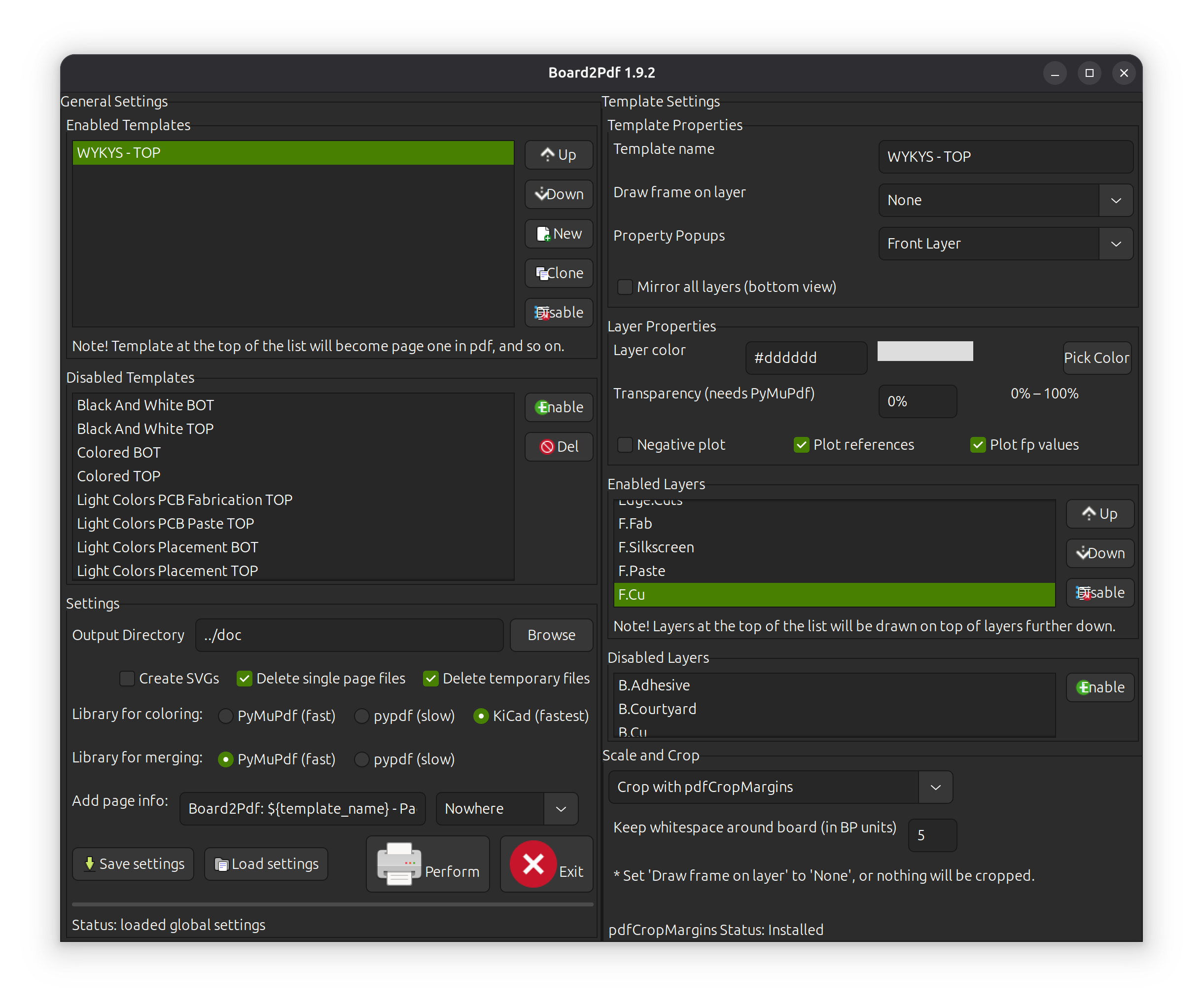

Greetings,
Previously, I managed (although unfortunately I do not remember the procedure) to print a layer of copper without filled holes for drilling.
I have a problem to achieve this behavior for a new installation. Could someone please advise me how to do it?

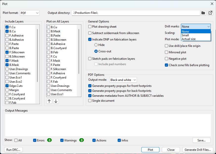

In KiCad 9 it’s possible to set the Drill Marks to None, Small or Actual Size.
I haven’t added this setting to be user controllable in Board2Pdf. It sets the Drill Marks to Actual Size for copper layers, and to None for any other layer.

Can you try the File → Plot dialog in KiCad to see if you can get the result you’re looking for? If so you could add a feature request to Board2Pdf.

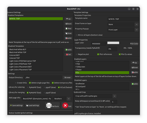

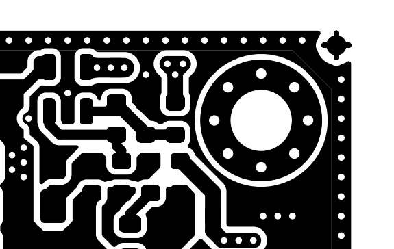

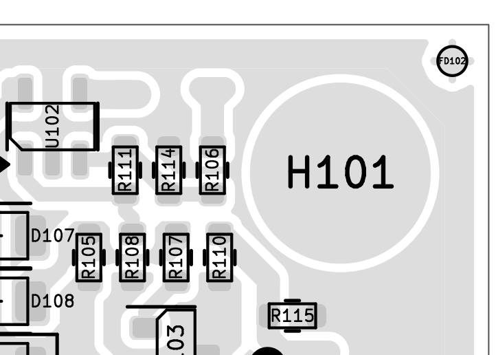

Hello, thanks for the response.
If I print directly to pdf, the holes in the copper are set to the current size.
However, if I print via the plugin, the holes are not there in the copper layer.
I am using the current stable version of KiCad: 9.0.3-9.0.3-0~ubuntu25.04.1
Version plugin: 1.9.2
