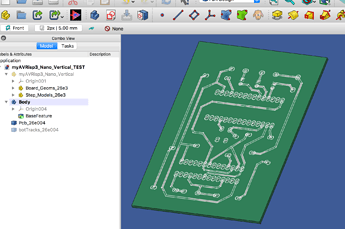

Re: Using FreeCAD to mill PCB Traces and Pads.
That would be the very best way to Confuse and Frustrate any student (and teacher). There are too many shortcomings that require knowledge and problem solving (not to mention Crashes).
And, there are no tools/features to tweak them beyond tweaking as you would other objects.
But, you can use the Stepup workbench to load Kicad PCB’s and Traces/Pads. Sometimes is works great, usually (not) but, that does depend on the details of the PCB and your FreeCAD pref’s setups.
Once getting the traces and pads into FreeCAD the Path workbench can mill them (after too much setup work… it’s Free so, try it)

Yes, it can be done in FreeCad and as mentioned, it won’t be easy, simple or of real use unless you/student’s like Torturing yourselves.
That said, I won’t detail the steps and in’s/out’s of doing it. But, after successfully loading board and traces and mucking about with extruding the traces/pads…etc, you can use Path workbench to get Gcode.
Video below shows only One trace (the left-most one) and simulation of Milling (in Freecad). I did not bother with setting correct Mill-Bit/etc…
