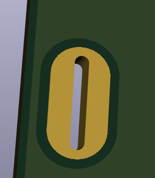

Yup . . .
From the 3D view . . .
. . . JLCPCB made them just like in the 3D view. They are just a oval pad with an oval hole. Nothing special.
