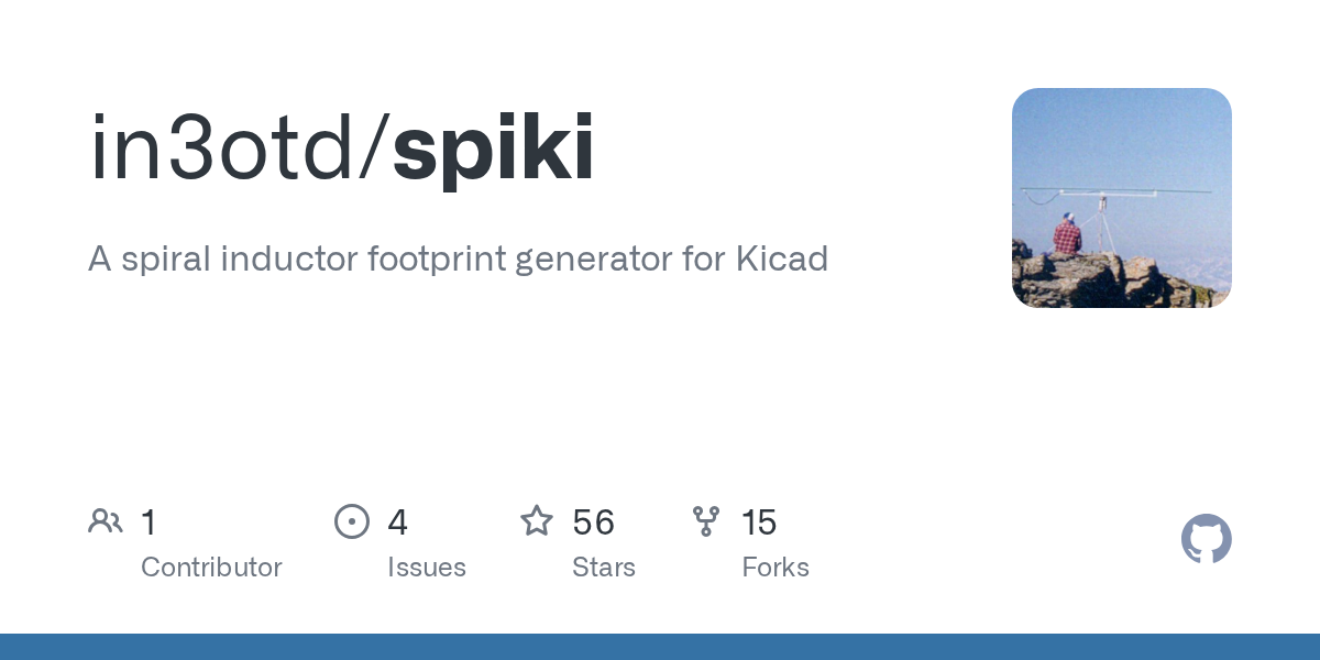

Or use Spiki, I have read good things about it:
tnx, but i have any 3d Model to convert.
If you read though the link I posted you will see that the OP for that thread also had limited python knowledge but the thread contributors talked them through the process. If you have the dimensions you can either programmatically design the layout or alternatively draw the layout in a drafting program and convert to a kicad footprint. I think the former is probably a more flexible general solution but the second is a reasonable alternative. If you have a design already, FreeCad and the Step Up plugin will convert your design to a footprint.
