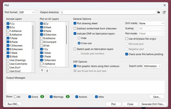

Thank you for replying @jmk . I followed the documentation and tutorials available on the internet, however, this is all that was available about DXF in the documentation:
DXF options
  • Plot graphic items using their contours: Graphic shapes in DXF files have no width. This option controls how graphic shapes with a width (thickness) in a KiCad board are plotted to a DXF file. When this option is enabled, the outer contour of the shape will be plotted. When this option is disabled, the centerline of the shape will be plotted (and the shape’s thickness will not be visible in the resulting DXF file).
  • Use KiCad font to plot text: When enabled, text in the KiCad design will be plotted as graphic shapes using the KiCad font. When disabled, text will be plotted as DXF text objects, which will use a different font and will not appear in exactly the same position and size as shown in the KiCad board editor.
  • Export units: Controls the units that will be used in the DXF file. Since the DXF format has no specified units system, you must export using the same units setting that you want to use for importing into other software.
To be honest I was not able to use the above information to my advantage. That is why I had to post my query here.
Ankit

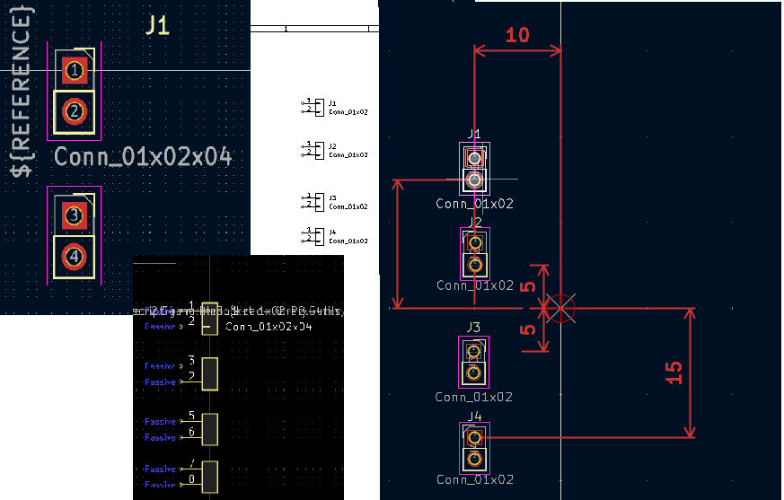

  1. Create a new footprint and schematic symbol consisting of a multi-pin, multi-connector assembly that combines multiple connection components.
  2. Specify the location of components on the board based on the origin of the X and Y axes.
  3. First, design a PCB with only the connectors, and then use that schematic and PCB drawing as a template to design a variety of more complex boards.
    etc.etc.etc…
And so on.
believe the data currently uploaded to GitHub contains too much unnecessary information. To simplify the problem, we recommend placing only the connectors on a new PCB of a specific size, and reconsidering how you connect them.
memo:
use the Move Exactly tool (Shift+M).

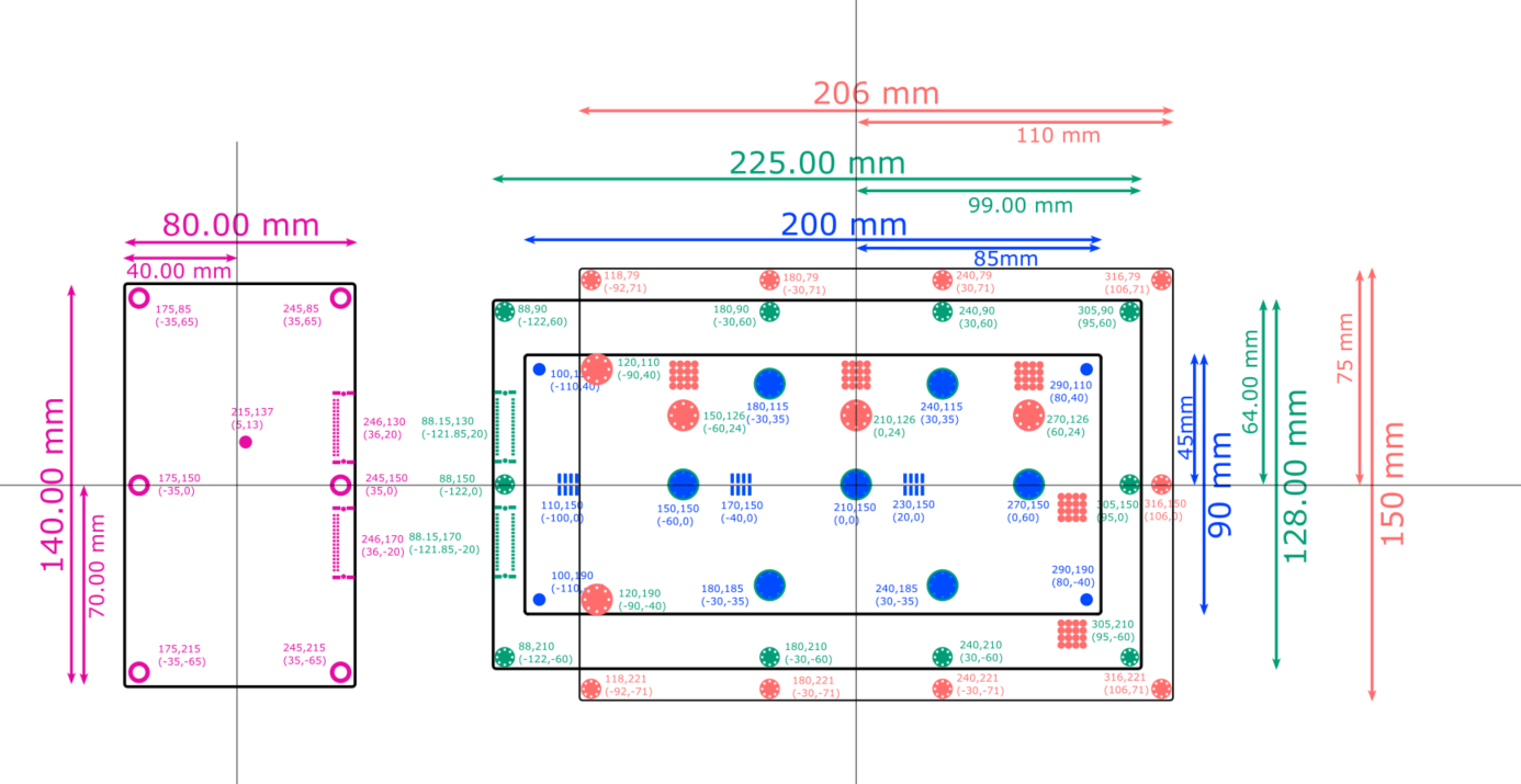

The key… Sketch it out, set EACH PCB origin to be the same and use nice round numbers for the centres to keep it simple in alignment.

Exactly. Now one workflow is an Mech-Eng does the bulk of the 3D packaging and then outputs a DXF that an Elec-Eng populates onto. This flow is the classic integrated project approach where the elec captures the circuit, does a ROM placement (especially connectors) and gives a required board area. Then the Mech-eng fully constrains a simple “PWB” to figure out other clashes to then feed back to Elec.
If you are doing it alone however and more biased towards an electrical flow, a sketch /really/ is needed. This is what I did. I chose the dead centre of one of the cards to be my “origin” then worked around that to ensure pillars align with plated holes or headers align with pins… This was done in Inkscape to then understand where I needed to ABOSOLUTE parts.
You have to work like this otherwise you have no chance. Then LOCK! those key parts, you do not want those accidently moving. Finally… Export to STEP and use something like freecad to pull all parts together

The simplest way is probably is to work on a coarse grid. I’ve standardized on a 2.54mm grid for such things, as it’s compatible with the legacy THT parts, breadboards and matrix / vero boards. When you put all “important” parts on such a coarse grid, then everything either aligns perfectly, or it’s so far off that it will be quite obvious upon inspection.
I also tend to use (127, 127) both as a grid origin and as some important coordinate on the PCB (such as pin one of a significant connector, or even just a fiducial) This coordinate is compatible with both metric and the bananas grid.
Others (such as Piotr) replace the “paper sheet” with some simple graphics (KiCad has a quirk that the sheet can’t be empty) and then use the “real” (0, 0) coordinate as a location mark on the PCB.

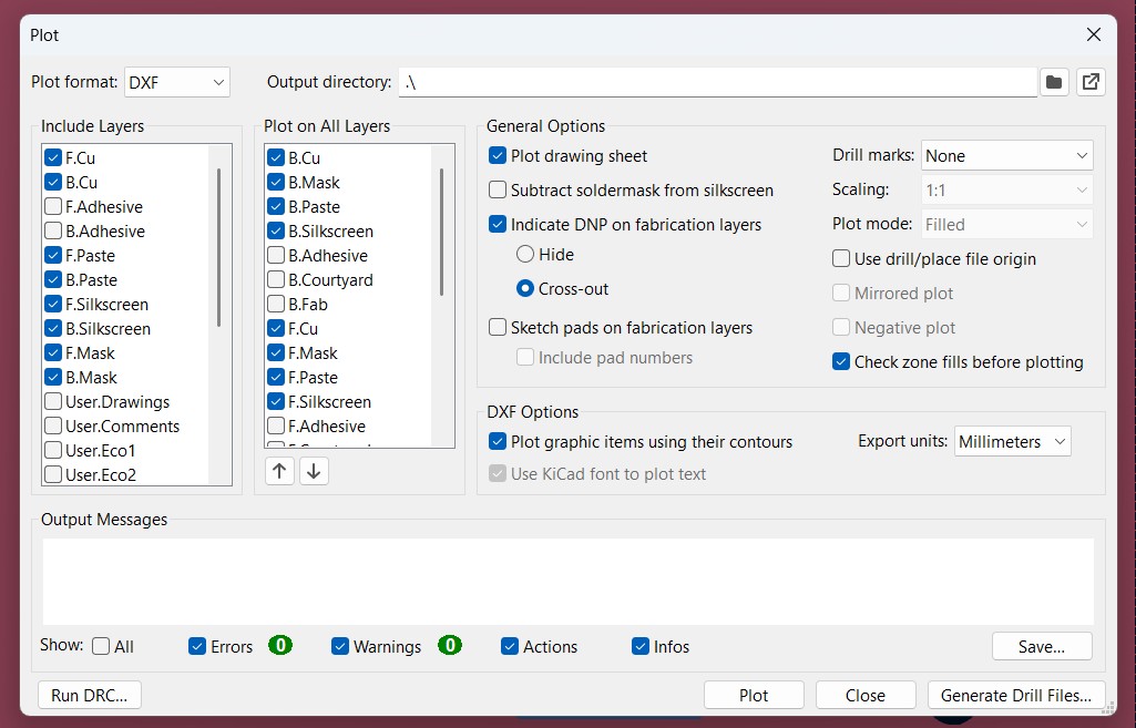

I had a peek at your github repository, but can’t do much with it as I’m still on KiCad V8. I did notice this screenshot:
… And that will create a lot of DXF output.
I think it makes much more sense to draw some reference graphics (such as pin one marks and connector orientation) on a single user layer, and then only export that single layer, and use it as the reference in the other project. Especially when combined with a coarse grid, this would make all alignment easy.

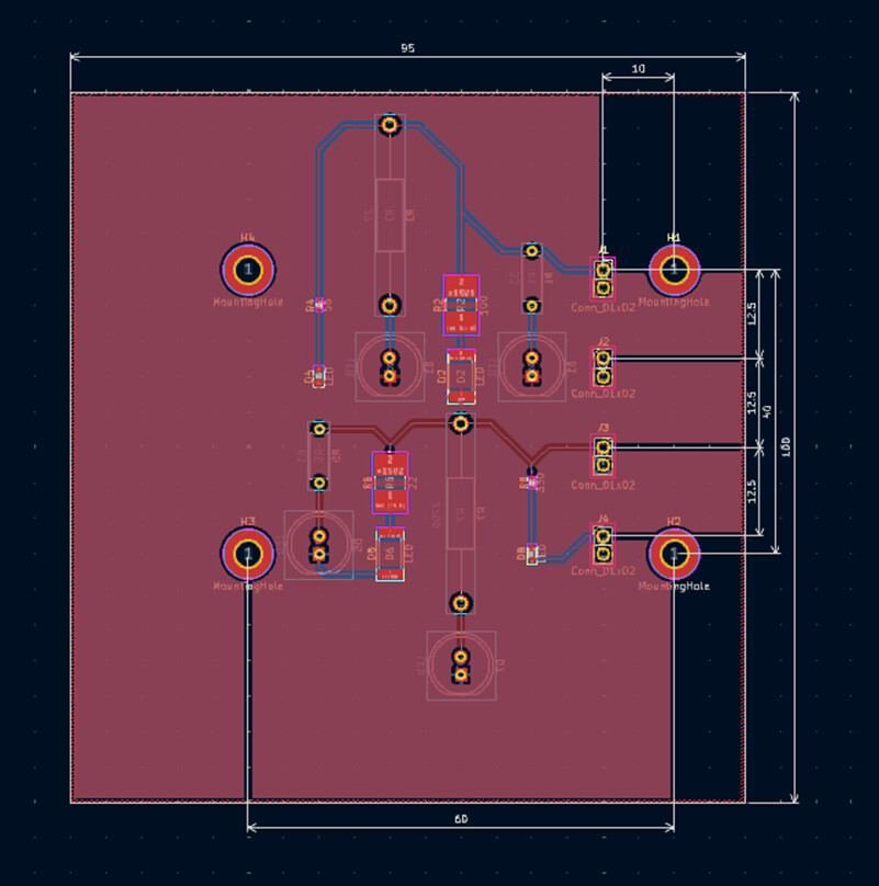

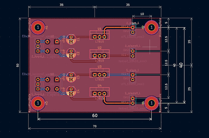

I followed your and everyone else’s instructions and I was able to solve the problem. Check out the images attached below:
This is the dummy power supply board with a dimension of 70mm X 50mm. The mounting holes are separated, center to center, by a distance of 60 mm horizontally and 40 mm vertically while the jumpers are spaced 12.5mm apart from each other vertically on its bottom layer. Also, the first and the last jumper are 10mm from the rightmost holes.
Next, for the dummy LED board the overall dimension is 96mm X 100mm. I copied the alignment of the mounting holes and the jumpers (jumpers being on the top layer this time) exactly onto this board and the job became simple.
Even though, the coordinates and the dimensions of the edge cuts of both the boards are different, yet all the holes and the jumpers align perfectly with each other.

Thank you for trusting, and visiting my github and browsing through the attachments. I am grateful for this gesture. I agree with you, I did end up generating 8 (I think) different DXFs. If a DXF has to be generated from KiCad, then which layer(s) must be selected in such a case? Could you share a screenshot of your DXF settings if you were to repeat the same task yourself? I could learn from it.

I advise you to become a bit more self reliant. for example:
Typing in “IMS” in some random search enginge finds things like the “Inddianapolis Motor Speedway” and “Insureance Management Services”, but if you combine it with “PCB” then it’s pretty much spot on.
How the plot window works is also pretty much explained in the KiCad manual.
