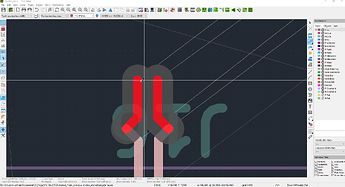

I am trying to place a differential pair.
I do the following steps:
  1. In scheme i assign name USB.
  2. In PCB i assign width, gap, cleareance etc. (suggestion, this can be managed on schema, one window for all track parameters)
    3)I make the placement.
  3. I need drag:
4)I press 6 and in walk around routing option an nothing never start to route
5) The differential pair propierty is w=0.265 gap=.1 clearance=.1
90 ohms for a 4 layer 0.2 first prepeg.
6) i change the board to 0.1mm first prepeg, and with the values w=19 gap=0.2 cleareance=0.4
I get error to the pin of the chip
7) I change the cleareance to 0.1, and the route didnt start without explicit reason
8) i change the cleareance to 0.3 and i can route.
IMHO Now the problem is that a cleareance of 0.3 is wrong because must be 2x W 0.4 and must be tolerated the chip connection.

Thanks. I removed all diff pairs from the board and routed them again without any issues (walkaround mode, clearances set as in the design rules). Do I need to do something special (change some DRC rules?) to make it stop routing?
T.
Yes try increase the cleareance for USB to 0.4mm (double of track width).
Or try use the tracks required for 4 layer with a prepeg of 0.2mm (w=0.265 gap=.1 creareance 0.5) In J301 didnt start routing at all
Do you mean setting the clearance for the netclass USB to 0.4mm, like below?
It doesn’t make sense because the distance between the pads in the USB2422-I_MJ is less than 0.4mm:
so the router will not be able to place anything there without violating the clearance in the first place. The diff pair gap setting does not override clearance settings…

It seems you might have a small misunderstanding of concepts:
Clearance is the minimum allowed distance between that net and any other copper on the board. Usually you set this to the smallest value your manufacturer can produce (0.1mm in your case). If you set this to 0.4mm it wouldn’t make sense because you’d get violations due to the separation between the pads in the footprint.
Diff pair gap is the required separation between the + and - tracks of a differential pair. This is probably what you want to set to 0.4mm.
Try setting clearance to 0.1mm and diff pair gap to 0.4mm. The router should then behave as you expect.

What I would normally do in this case is to route single tracks from the chip a small distance away with the smallest clearance, then create the largest clearance and from there use the differential pair routing as desired
It seems that the way Altium works is pretty advanced, but it is not how currently KiCAD works, you may add a desired feature in Gitlab and if enough people upvote it, it may get implemented.
You should be able to use Custom Rules to specify what you want.
