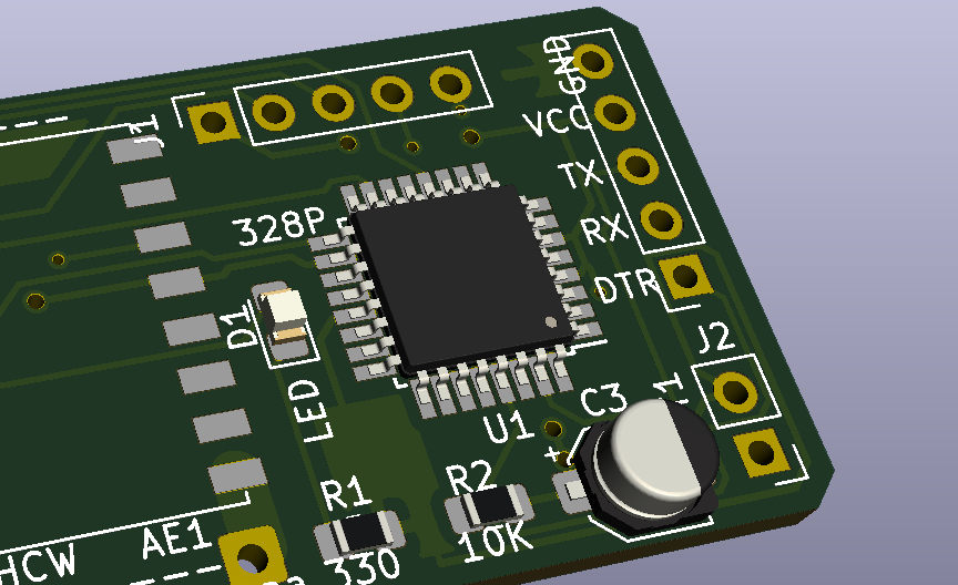

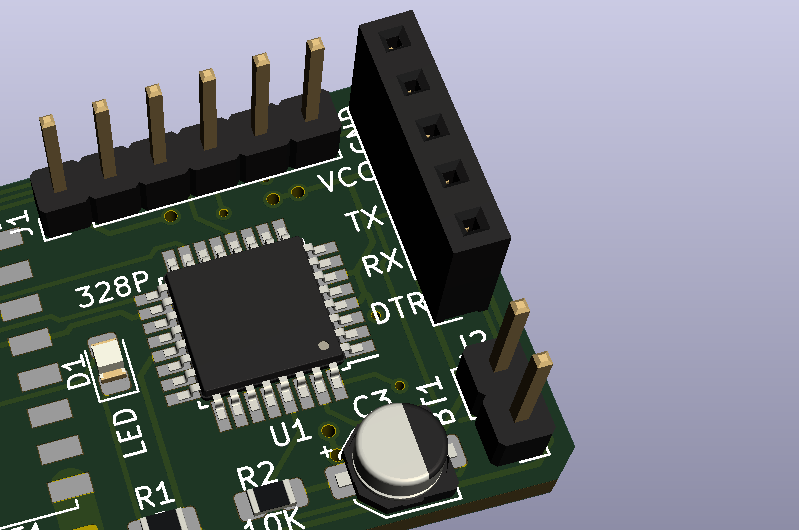

I just try to make my first PCB.
I have a problem with a ISP connection on the board,
cause I inserted a Pinheader but I don’t want to see the plastic header,
I want just the holes.
Can anybody help me to taje it out the plastic and let there only the holes please ?
Thanks all in advance
Denis

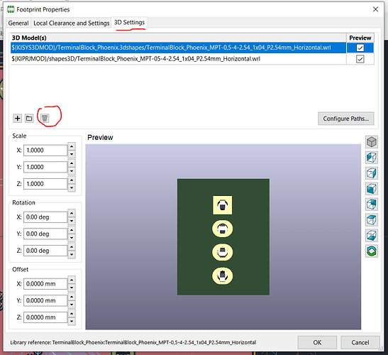

On your board go to your footprints properties, on the tab “3D Settings” remove the model of your footprint.
This will only affect your board, your library will still have the 3D model in case you need it in the future.
Whoaw… now is greate :slight_smile:
Thanks a lot
