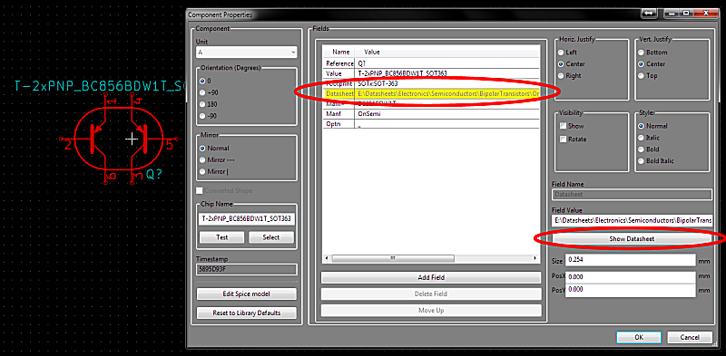

Personally I link pdf’s in the component fields and don’t get any links anywhere in the GUI for pdfs. I have to ‘edit’ the component properties to be able to load the pdf.
But at least I only have to care about one place to get my component/part definitions right - the lib file. I don’t care about the content of the dcm/etc. files.
