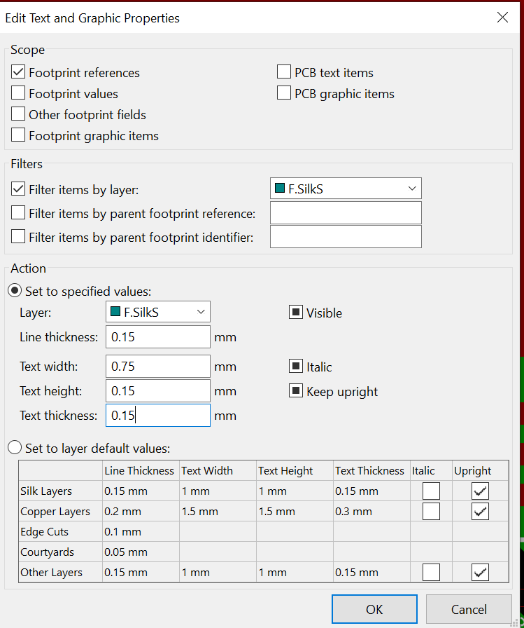

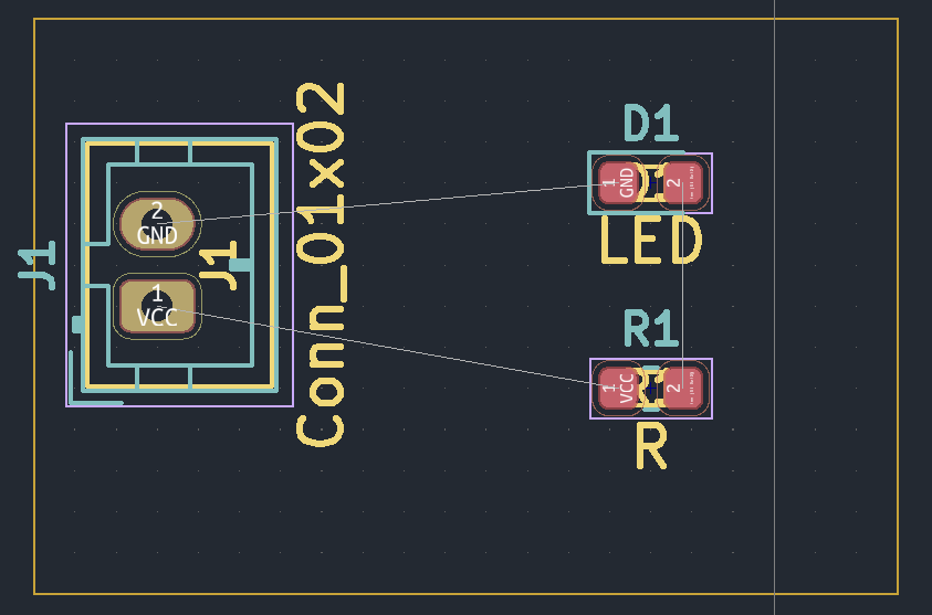

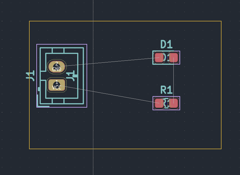

Using the dialog “Edit text and graphics” duplicates the component designators
Simple board:

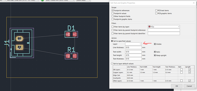

Using the dialog (Edit->Edit text and graphics properties)
Duplicated designators
A workaround (and maybe the inteded behaviour) was to use the filter:
then it works as before (and as expected)
Has anybody else noticed this behavior ?

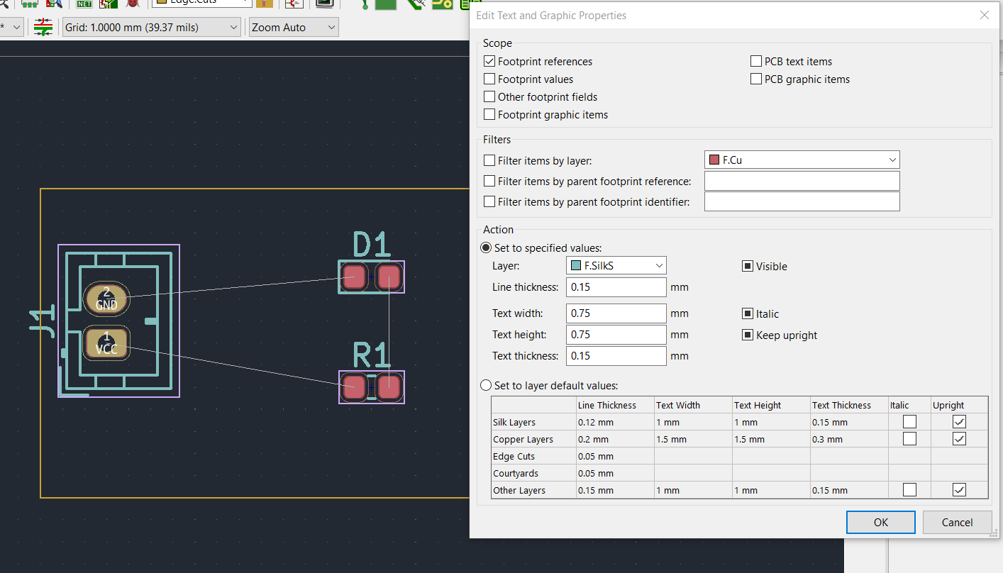

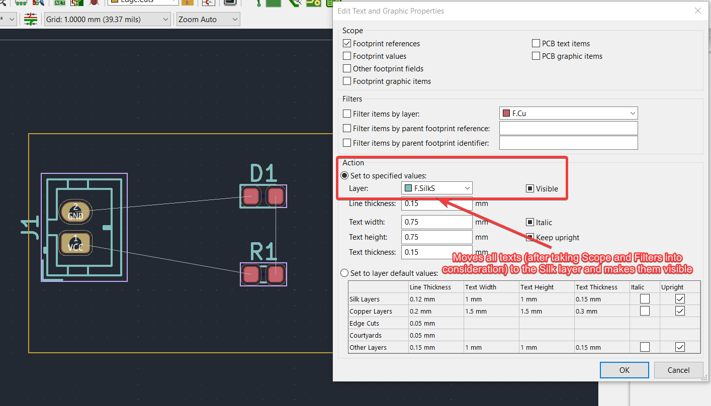

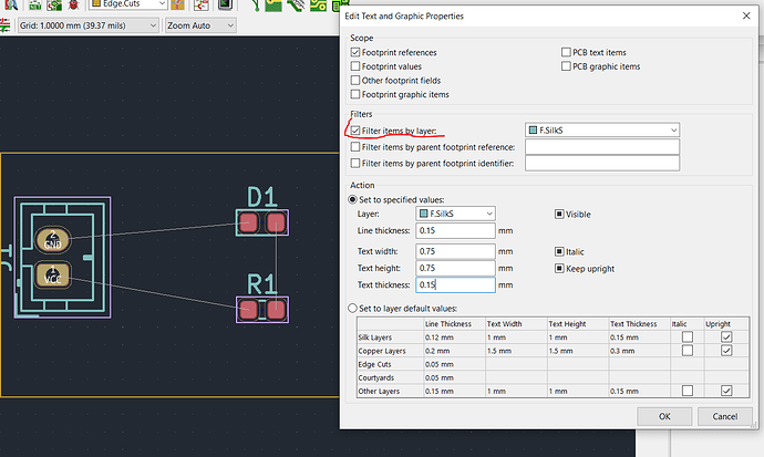

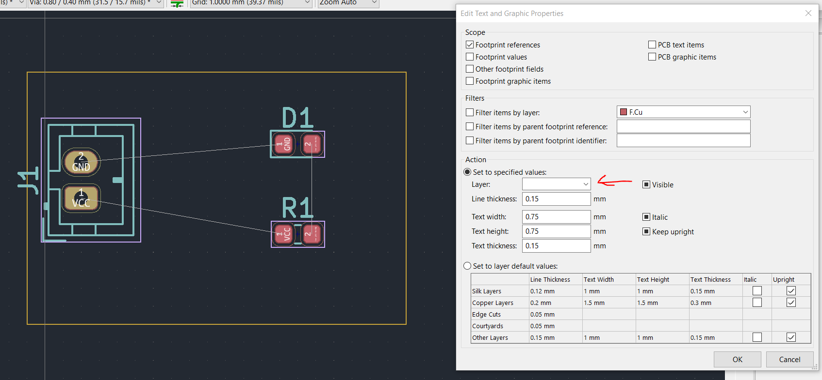

This is because there is a hidden designator on each footprint which is normally on the x.Fab layer that then gets set to x.SilkS. The correct way (as I understand it) is to use the filter to select the designators only on the x.SilkS layers. This will prevent the x.Fab designator from being set to x.SilkS layer.
In other words,

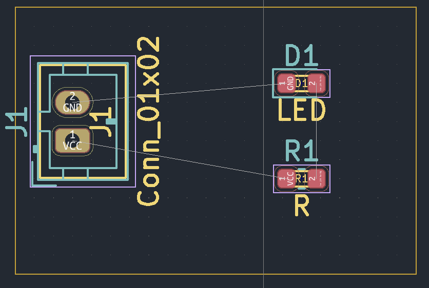

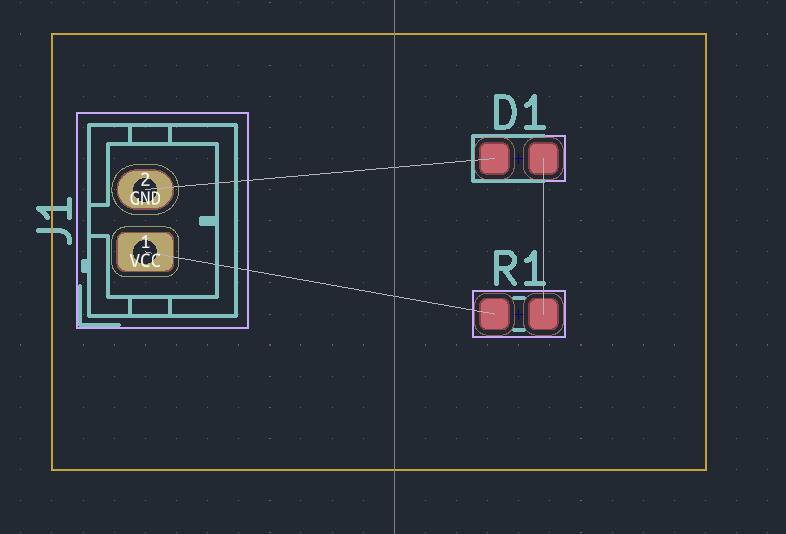

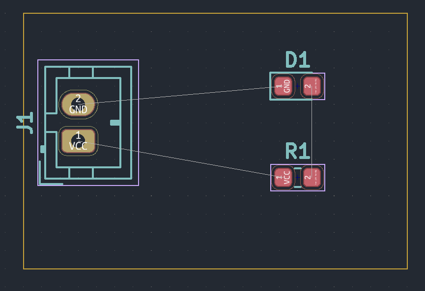

Ok, I checked and if you don’t select the layer, you don’t get duplicates
Result:
Altough the stuff in the Fab layer does get modified

But if you understand that Scope and Filters tell what is affected, Action tells how it is affected, you know what you need to know. I don’t know how “Set to specified values - Layer” could be any more clearer or easier to indicate that it changes the layer.
As I said, now I understand it but it is one of those things that would be ideal on a expandable dialog, but the standard case should be “I want to change X to Y”, doing “From ALL LETTERS select the X and change them through MODIFIER to Y” I agree that it is extremely powerful and I like it but I doesn’t solve the normal case easily.
My normal case is that I want to change all footprint refdes and values in the fab layer to a certain value, to create a readable assembly instruction. So, I use Scope: references, value. Filters: F.Fab. Action: specified values - text width/height/thickness.
Then I want to change the refdes in silkscreen to certain size. Scope: references. Filters: F.Silk.
