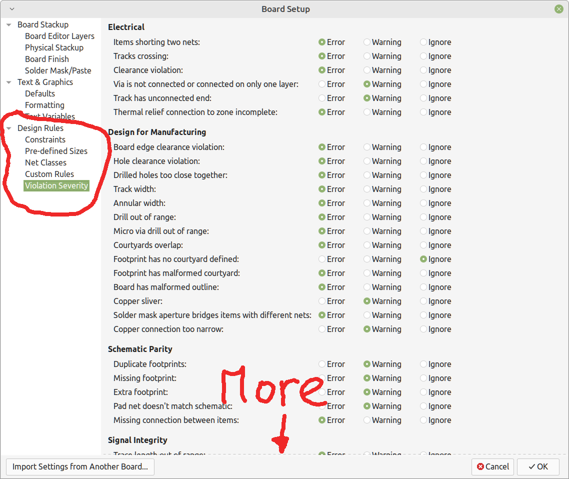

I guess that quite a lot of people (and especially beginners, students and hobbyists) do not need the custom rules and doing this all in text would make it more difficult to get started in KiCad.
There are also just far to many settings to fit on a single page. Have a look at the long list in PCB Editor / File / Board Setup / Design Rules / Violation Severity
I find the way the design rules are now divided over several pages with settings intuitive and easy to use.

FWIW, all the constraints on the Constraints page are compiled into rules internally.
But we keep a separate interface to have a more graduated learning curve and to allow simpler boards to not have to use custom rules.
