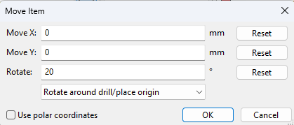

For board rotation, use Shift+M (Move Exactly…):

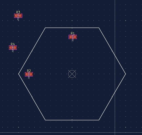

I still think there’s an option missing here to rotate selected parts around the coordinate origin.
As in the example image here, you can then set the coordinate origin in the center of the board, and all rotations will then revolve only around the central point.
You can use the drill/place origin for that:
Nope… If I haven’t missed anything here, this is the result:
It has rotated by 60°, but also left the drawing sheet, although the coordinate origin was previously set in the center of the board.
On this screenshot I only see a grid origin set.
You have to set the drill/place origin.
Press and hold the left mouse button on this button and select the right item:
Thank you so much! That was what was missing.
