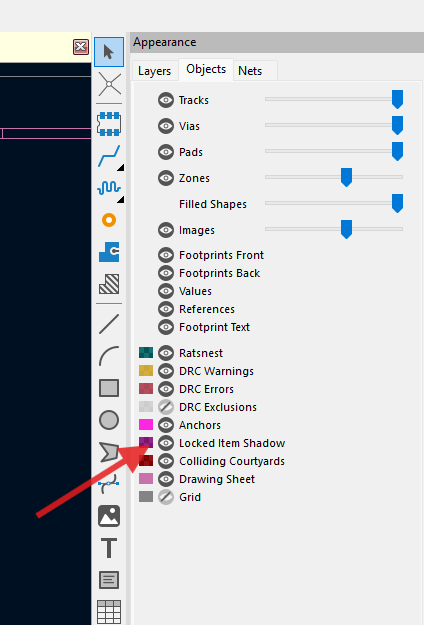

PCB lay-out turned purple
Not sure what happened. Maybe I inadvertenly hit a hotkey?
How can I fix this?
KiCAD version 9
This is Locked Item Shadow. You can unlock your elements (L), or disable the shadow:
Thanks. I was messing around with locks. The outline of my enclosure is (obviously) all around my PCB and I locked it to avoid unwanted selection.
