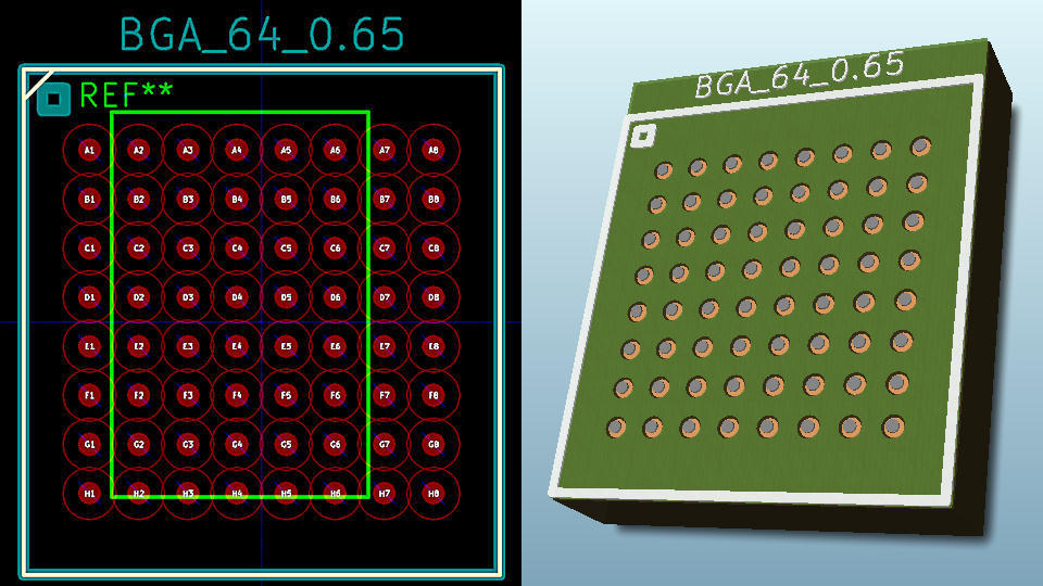

I am using this http://www.onsemi.com/pub_link/Collateral/AR0330CM-D.PDF. On Pg 70,71 thee is footprint information. I created a footprint using the footprint wizard. Could someone please check this?

Your F.Silk lines are not up to scratch… why didn’t you just change the gridsize to something bigger like 0.1 or 0.2 mm and did one line per side? - it doesn’t need to be 100% on the housing dimensions, as those have errors and the silkscreen has got a placement error that is even worse…
ball-pitch is OK.
ball-pad size… no idea, any datasheet for that? The ones from OnSemi for that exact housing are emptymight want to write to a sales person/distributor to get the recommended footprint for a part like this?
Judging from a ‘similar’ package (pitch 0.5 mm, 64 pads, https://www.onsemi.com/pub/Collateral/567HW.PDF) the pads seem to be ~20% larger than the balls… (0.22 vs 0.27).
Means, if the ball diameter ‘D’ is given as 0.25 on page 71 of the AR0330CM datasheet you’d want to go for 0.3mm pad diameter… you got 0.25 mm - not enough to make soldering more successful.

In that case there I marked out the area where the receiving pixels of that CMOS are… but I forgot to mark the center coordinates with a crosshair. My bad.
This footprint doesn’t obey the rules that KiCAD librarians have set, nor would anyone else approve them.
  • The 1st pin marker is under the IC once soldered - bad for post-production check up, at least it’s not a circle (had one batch pcb come back from china with circles in F.Silk missing some time ago).
  • REF** field should be on F.Silk and bigger, so you can put it besides the IC for placing the components/whatever - good fr checkup, maintenance.
  • The housings outline is usually not on Dwgs.User… but some other layer.
    Stuff like that.
    I have my reasons why I do it this way, but that’s me.
    As I reworked that footprint I added it to my lib, so I obeyed my private standard, but uploaded it for you so you can (with some little tweaking) get it back to KiCAD/whatever standard you like but with the improvements.

I just switched to Cairo and see that the FPaste layer touch each other. Is this okay?
I think that’s the pad clearance (min distance for tracks or other pads around it) as long as they don’t overlap OTHER copper pads/tracks all is fine.
My KiCAD feels bonkers atm for me in this regard. I couldn’t get a real grip on the pad clearance, soldermask clearance and paste clearance. I just set them pretty small so the footprint looked alright in 3D… needs observation when being placed onto a pcb for sure.
