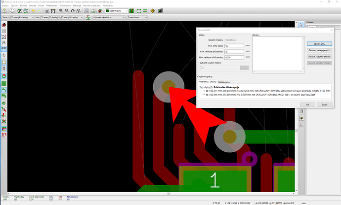

Hi, i have a problem in my PCB layout. If i have a track a next to this track i place a drill as close as kicad enable me. but after that if i click on DRC check, is there a problem with clearance od this track and drill and i have absolutly no idea why. Clearance is 0,2 mm.
Now i do it like that, i set clearance on 0,201 mm (place the drills) and after that a set clearance on 0.2 a run a DRC check and everithing is ok, but this is stupid process.
Thank you for help.
I think that you might have run into this bug:
I don’t think that this has been ported back into the stable branch, however.
thank you, but i do not now haw can i use this, even if i read the install.txt
Do not use development builds if you do not know what the dangers are!
For the stable you can play around a bit with the drag tool to resolve your problem. It allows you to move the via a bit out of the way.
To activate the interactive drag: in open gl (F11) ->preferences -> interactive router: in this dialog select interactive drag under mouse drag behavior. Then drag your via with M (you will see that even with pressing M the offending wire might already be pushed out of the way.)
Note: In newer nightly builds the drag tool has moved to the shortcut D (Not sure if M still works there. I currently don’t have access to nightly)
