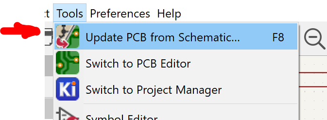

Based on that description, and also on your schematic and PCB, I still suspect you haven’t updated the PCB from the schematic (Tools → Update PCB…) but have just followed the schematic visually. If that’s the case, you could have as well used pen and paper for the schematic and are missing critical features of an EDA suite. Please read the Getting Started document (linked above by Piotr) at least once before continuing.

When you were routing tracks at PCB have you followed connection lines you get after updating PCB from schematic?

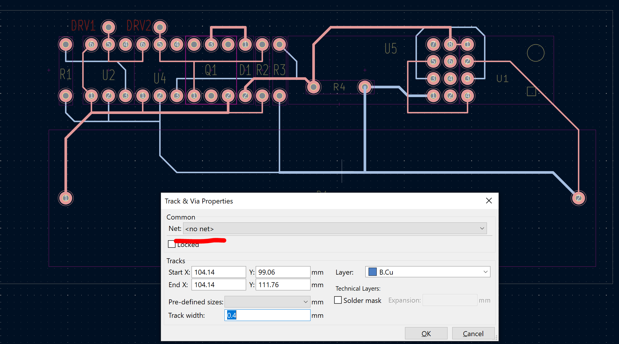

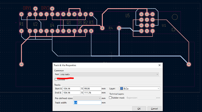

For me it is difficult to interpret this setence. It is easier to tell what I did. First I created the schematic, second the symbols, third the footprints, fourth the footprint assignment. That is I followed the standard procedure. Not without problems because I expected the kicad to be more beginner friendly. I did nothing illegal, in the sense of respecting the basic rules. When I ran ERC for schematic i had to adjust something but thi was not complicated, but when I ran DRC on PCB layout I received a lot of identical error message all about solder mask and bridges. Assuming that the reason could be some improper clearance clearance I tried to modify some footprints, mainly modifying the drawings on courtyard layers. But then I restored the footprints as they were before ( I called this “updating the footprints”). I wonder that all the arrows indicate that the problems are located to the points where 0,2 mm wide tracks reach the footprint pads. I am not able to imagine problems in a so simple connection. I have add a zip file which, as I have understood, should include the entire project. This is all can tell.
You have no nets in your PCB layout, at any point did you use the Schematic to update the PCB ? Using F8 or the Tools menu ?

Run ERC on your schematic, and fix all the errors, then update the PCB from the Schematic once you fix your footprints.

When PCB design program knows schematic it draws connection lines showing you what you should connect with what. Knowing if you had these lines was a key to understand your problem here.
It is why I have asked: “When you were routing tracks at PCB have you followed connection lines…” and informed you that these lines “you get after updating PCB from schematic.”

I have never worked with KiCad having no nets so I don’t know what exactly is happening. Each pad has solder mask opening and track comes to this pad so goes into the same opening.
Normally they both (pad and track) have the same net assigned, but here they don’t.
If they both are ‘no net’ than KiCad should not complain that different net elements are in one opening, but may be it knows that one ‘no-net’ is not the same net as the other ‘no-net’.

I assume there is no link between the Schematic and the PCB. I guess this may have happened by the OP creating the Schematic . . . then creating the PCB by adding the footprints one by one and then routing the tracks . . . rather than using F8 to update the PCB from the Schematic.
But still you didn’t tell if you used the Update PCB from Schematic function from Tools menu. That’s the critical point. Also you haven’t told if you have actually read the Getting Started document.

But what happens if at PCB everything is no-net? In soldermask opening there is probably no-net pad and no-net track, but KiCad writes that there are two different nets in one opening.
No-net and no-net is for me the same net :slight_smile:

Yup I agree, but without any net information the DRC is pretty much useless, the OP needs to fix this fundamental issue then report back with any new issues . . .

My wise helpers. I apologize for having underestimated the importance of the study before the action. My behaviour has been also against my life experience and my strong attitude to acqire information by means of constant intellectual application. I have used a method dictated by my presumption of quickly learning under the pressure of time shortage. I am glad to tell you that I have read Getting Started with Kicad, I have modified something in the schematic, then I have redone the PCB layout using the tool Update PCB from Schematic and the miracle happened: no more errors with DRC test.
