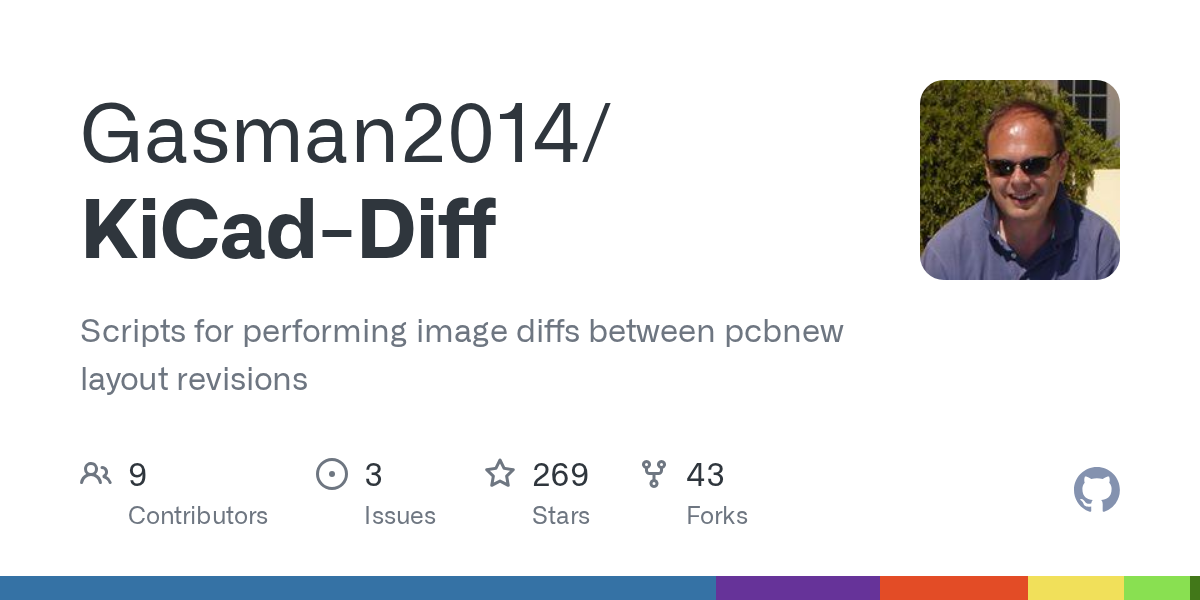

KiCad-Diff uses a combination of Python and SVG.
And Kdiff which apparently builds upon KiCad-Diff also has Pan & Zoom at 01:50.
it’s definitely on ‘todo’ list
I saw this project, it is more tightly related with KiCad whilst my tool is generic svg diff viewer. I think there is a room for both.

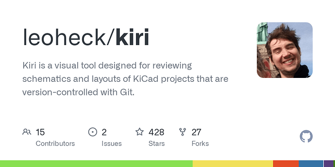

I haven’t updated KiCad-Diff for a while as I have had a lot of other issues to deal with but a colleague who is sometimes on the forum @leoheck has spun off a more polished and complete project - Kiri.
This has a cli (as well as a gui interface) - the cli might fit your needs - and will compare svg diffs of schematics as well as pcb layouts. It builds on some of my code which uses a feMatrix transform function to highlight areas of change.
One of the challenges is to cope with situations where the entire board is moved. A helpful feature would also be to identify nets within the diff.
