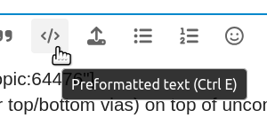

You can also use the Preformatted Text button to include “difficult” characters in your text on this forum.
A section of preformatted text. This is placed in between backticks. )(*&^%$#@!><|\
