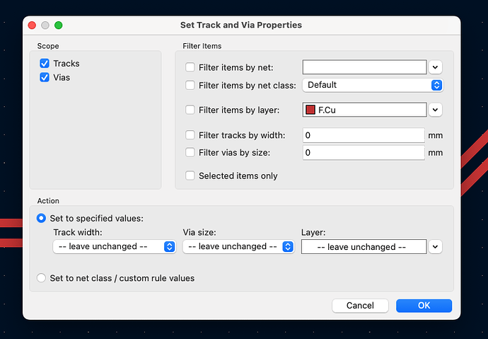

And yet another way: Use the Edit Tracks and Vias tool in the Edit menu
  1. Set scope to just Tracks
  2. Set the Filter to capture what tracks you want: maybe all tracks on a certain net, etc.
  3. Set Action to what you want: maybe set width to a specified value
