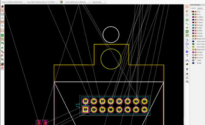

I’m using kicad v6 and when I flip a component over to the back side it disappears even though nets still show up fine and you can see the part on the 3d model. Layers are set visible.
Anyone know what’s causing this and how to fix it?
Look in the right sidebar. It has two tabs (Layers and items)
Switch it to items and check if you have disabled visibility for bottom footprints.
