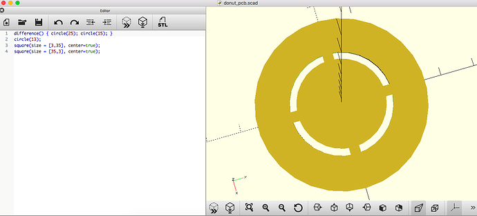

I’m trying to have circular boards+mouse bites+internal cuts without having the 3D viewer complaining about non-contiguous polygons. Has anyone succeeded on placing the mouse bites (i.e https://github.com/madworm/Panelization.pretty) while having Edge.Cuts not being perfectly aligned for each segment?
I’ve tried drawing a circle in the middle and adding the mousebites later, but then the middle board is gone and I’m left with castellated mouse bites.
Then I tried drawing partial arcs in the center, interspersed with mouse bites every few degrees, but then the 3D viewer complains :confused:
Any good hints? Thanks for this interesting thread!
For complicated pcb outlines you need a CAD tool that can export DXF that is understood by KiCAD.
I wouldn’t try to do any panels/sub-boards other than rectangular ones with KiCAD really.
Thanks for the feedback, @Joan_Sparky ! I did a small OpenSCAD sketch of what I want to achieve:
And I successfully imported the resulting DXF to KiCad, adding four mouse bites footprints on the inner circle:
But the 3D viewer keeps complaining, more or less as before regarding Edge.Cuts interior graphics error as shown before :confused:
Any hints on how to please the 3D viewer are super welcome!
Try that one…
brainstorm.dxf (291.7 KB)
