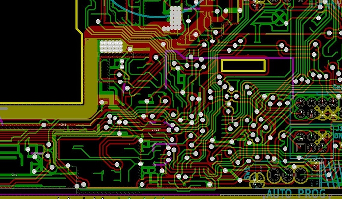

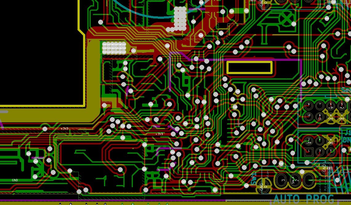

I’m scratching my head on this, tried all the buttons, but the pads do no show on the display. they print OK,. but it’s a nighmare to work the design. I have to do a fix on an earlier design. just in the layout.
any suggestions ?

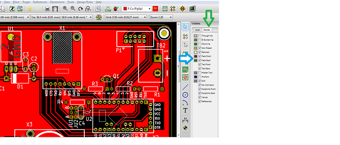

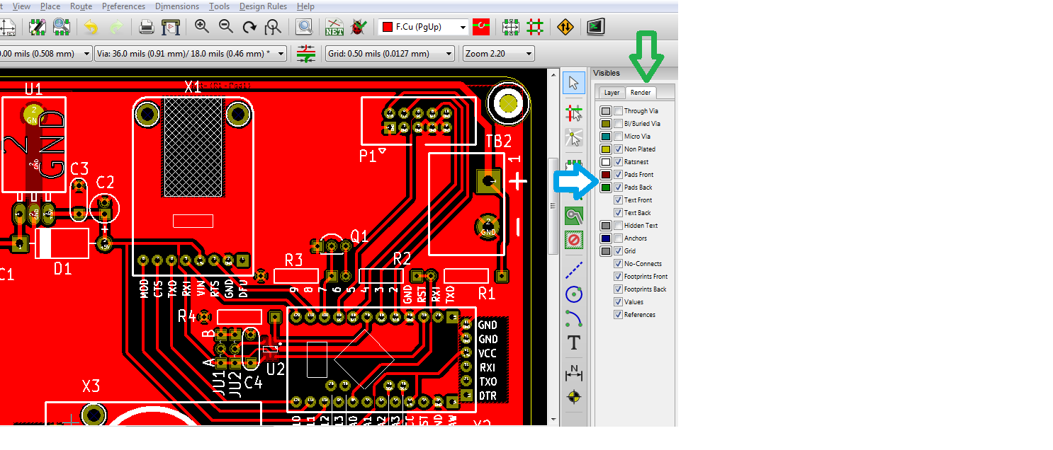

Are the front/bottom pads turned on in the render tab (the tab to the right of the layers tab.)
