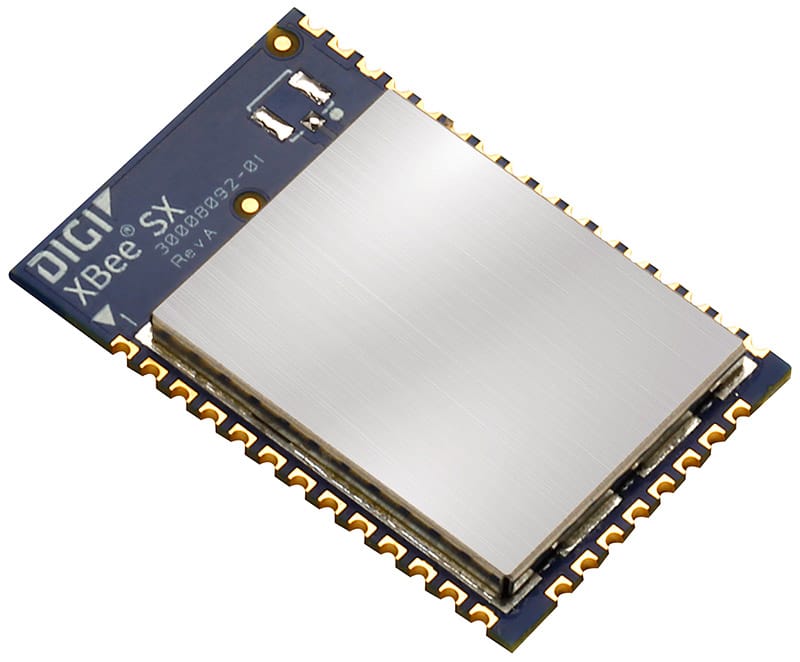

How can I make pads similar to those of these cards?
https://images.digi.com/products/xbee-sx-pad-ant

Search this Forum (and other web sites related to PCB fabrication) for the term “castellation” or “castellate”.
Not all board fabricators support this technique.
Dale
Castellated Edges by OshPark

I have seen someone web pages like this -> http://prototypepcb.com/castellated-holes/
Also the Hack project to Kicad, very interesant.
Best regards
I did it with a single pad because I do not have space. Now I have to verify that the pcb shop can do it.
