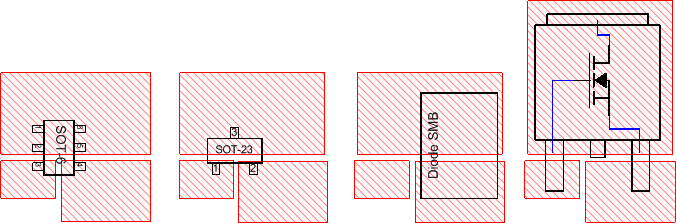

Please all keep in mind vindi93 is requesting a schematic symbol. Given the 6 pin SOT package, the symbol needs to have the correct drain pin connections to correspond to 4 drain pins in the footprint. PCh MOSFETs in SOT-6 are not the most common but not so rare either so something probably exists. I think I have built boards using Pch SOT-6; before I got with KiCad. But I like to edit my own schematic symbols anyway.

BTW for SOT-6 MOSFET Footprint (not schematic symbol) I like to put the four drain pins on one big fat pad. This is good thermally and performance-wise. My resulting footprint looks like an oversized 3 pin SOT. If you want to do that then you might want to define the symbol as having only 3 pins. These are methods I use for my home-built boards; perhaps some manufacturing operations would object to doing things this way. But it is easy to hand solder and works well when powered up.

I view the situation differently. The SOT-6 is designed for higher power (and better dissipation) than a SOT-3. MOSFETs almost always run better when cooler, so I want to provide more cooling copper rather than less. Sometimes we want a smaller MOSFET for a variety of reasons, including reduced gate charge or perhaps price. In many cases, the MOSFET ON resistance is used as a sense element for current limiting. Or maybe those are the parts we are using elsewhere. So cooling a smaller MOSFET with added copper zone may well be more attractive than using a larger one without extra copper. I almost always avoid thermal relief in this situation as it largely defeats the purpose of cooling the FET.
After my post I thought about it and realized that a top layer copper zone is probably the best way to go to cool the FET when using competent tools such as KiCad. It avoids confusion when you have the schematic and footprint agree with the device datasheet. Using one big pad invites confusion if the device obviously has 4 pins. I had previously done many boards with ExpressPCB which has no DRC, and the cheapest boards have no solder mask. So you mostly do whatever you want and be careful as heck to avoid stupid errors.
One more thought: When I was an apps engineer at a semiconductor company, our power eval boards would often use a footprint which could accommodate a variety of packages so that the user could experiment.
This example shows how a SOT-6, SOT-23, D-pak, or SMB diode could all be placed on the same pcb footprint. The schematic would probably indicate a generic symbol without attempting to show multiple drain pins. Just now I stretched the drain pad to fit the D-pak but I think you can imagine how all 4 devices would fit the same set of pads. In this case the FET may be used as a synchronous rectifier so a schottky diode in SMB package is one of the options for test.
