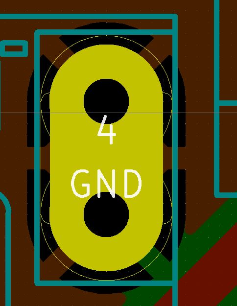

Oval pads with two holes : no ground connection when filling ground plane
I have a problem with a couple custom footprints I created (the example below is a well known buck converter module). Through hole pads are made of two pads : oval + circular. The symbol has pads #1 and #4 set to “power input”, and they are connected to ground in the eeschema.
When filling the ground planes, these pins are not automatically connected to ground.
Why ?
Of course, I can put thermal spokes by hand, and they will not be removed by the 'Cleanup Tracks and Vias" command. But if I change the thermal spoke width in the “Copper Zone Properties” dialog, I will then have to edit the custom spokes widths.
I tested “Pad connection : Thermal relief” in the pad Properties dialog. Gives me this (too much copper around one pad, no copper around the other) :
or
I tried assigning no number to one of the two pads. No success.
I also tested this : I swapped the pads definitions in the kicad_mod file, thinking of some problem with z-order (round first, then oval and vice-versa : who knows…). No success.
I’m out of ideas.
Is there a way to define custom spokes in the footprint editor ? Something like this :
Is there a limitation for such pads (I understand it’s a hack), or did I miss something ?
If you’re willing to Hack… This may work for you…
Oval Pad
THT Y-Offset
Copy&paste it, Rotate the pasted one…
Change one of the Pin numbers to ~
(or set desired pin number or, ‘invisible’ the one you don’t want)
[EDIT] Just for fun… you can make a Custpm Pad (Graphic Polygon) and trace around two Circles… Quickly/Crudely traced and I didn’t clean it up or set Pin numbers to same or/other… Image below…
bingo!
(did not bother to hide extra ref or label…)
The Custom Pad version…
Results

Just had a look at the JLCPCB drilling capabilities : 0.2mm. We get this : the result is just perfect, and it works perfectly with the zone filling tool ! 2 round pads, and a square one in between (same dimensions), with a 0.2mm hole.
Pad 1 : two square pads side by side, no third pad. Works perfect !
Capture11
I think the problem is solved !
(probably reinventing the wheel)
[EDIT] I tested with a 0.0mm hole for the third pad. Kicad just says there will be no hole…
Capture13
Setting a pad number for the third pad (middle), and none (empty field) for the others gives a much cleaner results.
Capture15
