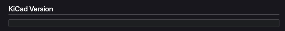

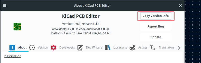

You need to copy all the version information from the about box and put it into the provided space (or just use the Help->Report Bug menu item). That contains things like your OS and graphics drivers which can be very important for performance issues.
Use this button:
Put it the provided box here:
It’s explained more here: Report an Issue | KiCad (item 7 in the screenshot).
Thanks for the info. I used the Report Bug option and I might have gotten it formatted well enough that the bot didn’t immediately close my post. Thanks!
