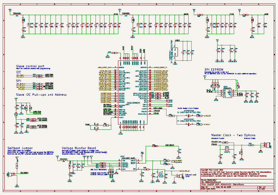

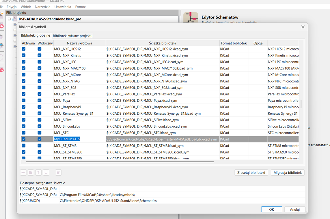

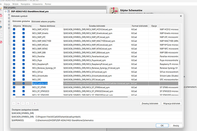

I want to open an old Kicad project, and although I’m adding the required libraries to the project, Kicad doesn’t see them. What am I doing wrong, or what is Kicad doing wrong?
Kicad project from: GitHub - aventuri/DSP-ADAU1452-StandAlone: Open Hardware DSP Platform ADAU145x DSP supporting ADAU1452, ADAU1451, and ADAU1450 devices

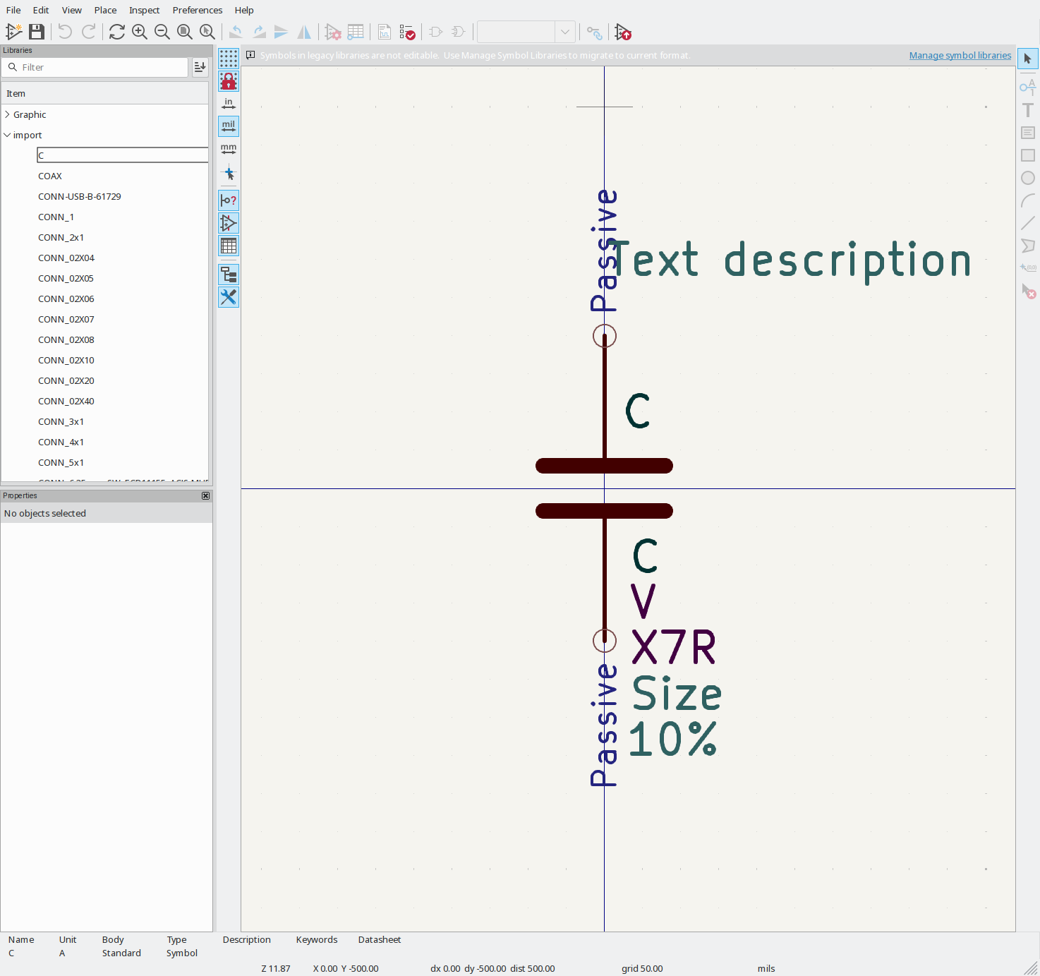

I tried importing the indicated library (in the original project) and was able to add it as a Legacy library.
I didn’t migrate it to the current format as this was only a test.

I thinkt the migration succeeded but the nickname for the library in the schematic is not the same as the nickname assigned by the OP to the legacy library, so eeschema failed to find the symbols.

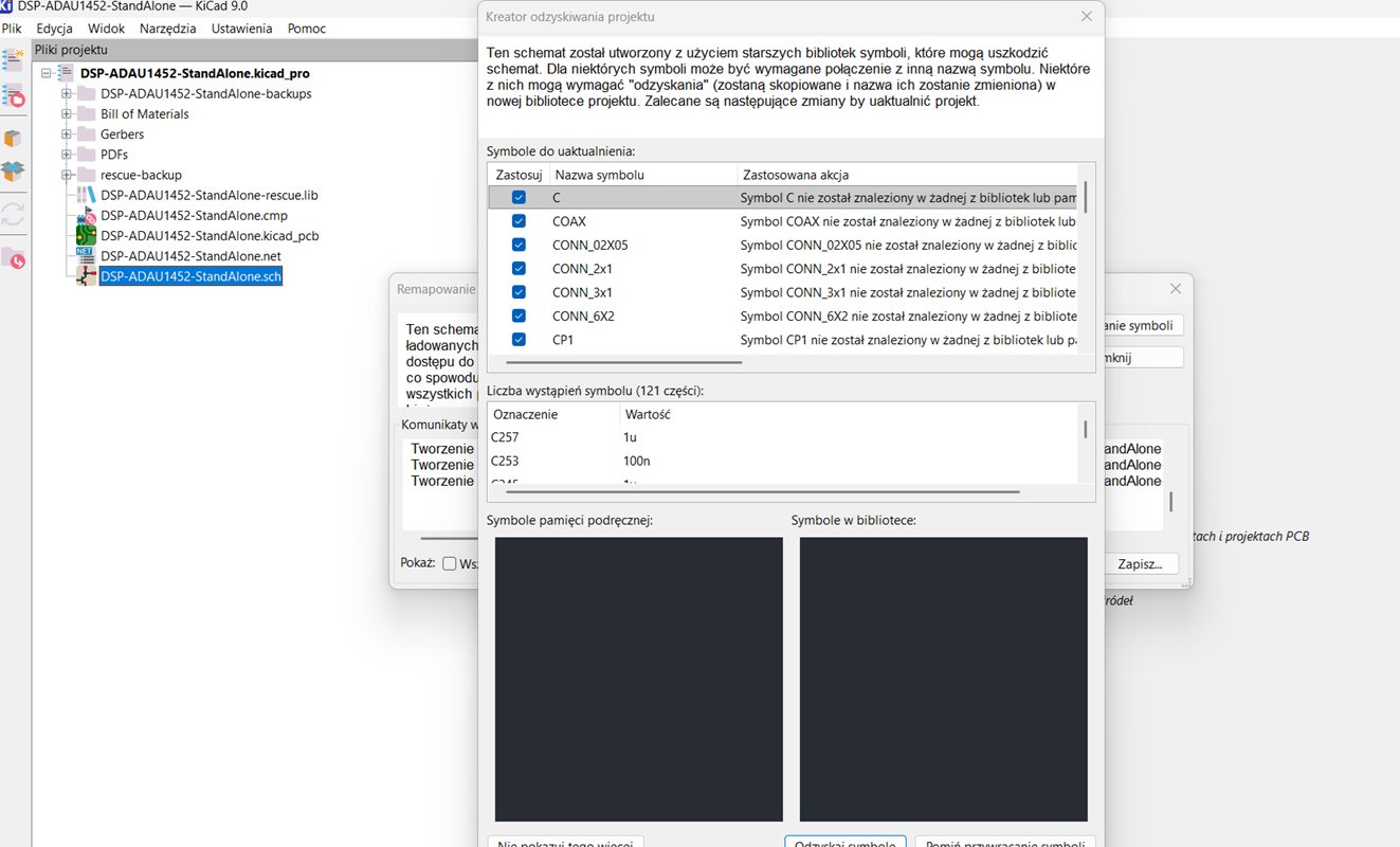

So there’s no way to open such an old project in KiCad? It’s a shame, though. It’s a very well-designed four-layer board, and now I’d have to start from scratch. I can’t even open the schematic! There should be some tool to migrate from the old version to the new one.
No, I think you can fix it.
Proceed by ignoring the not found errors. A lot of the symbols will show up as question marks in the schematic. Select one to edit the properties and note the nickname of the library, the part before the colon.
Then go into Manage Symbol libraries and make the imported library nickname the same as this. Pay attention to the case of letters.
Now reopen the schematic and see if it’s fixed.
Before you do this, make sure you can view the symbols in your imported library.

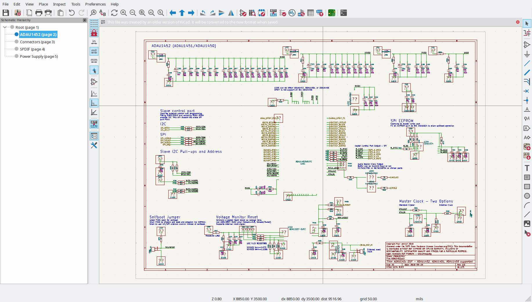

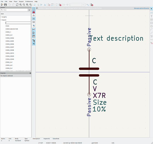

Edit: Ok, I opened the project in v8, then added the MyKiCadLibs-Lib as a project specific library. When I opened the schematic I got a lot of ?? symbols.
The trick is to go to Tools > Edit Symbol Library Links and fix up all the orphan links to point to the imported MyKiCadLibs-Lib. There are a lot so it’s tedious, so I only did a few, but as you can see from this screenshot, some progress has been made.

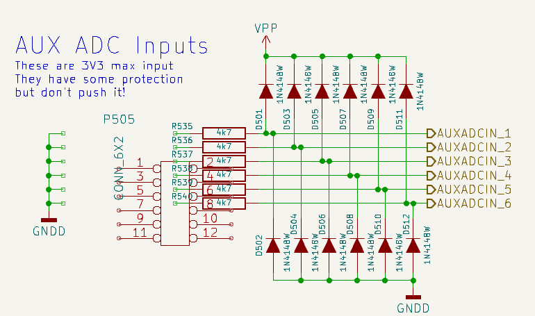

I could not add the MyKiCadLibs-Lib.lib to the project normally. KiCad detects it as a legacy library, but for some reasons it seems to forget it, and even replaces it in the library table (I added it as a project specific library). After a bit of fiddling (copied the “MyKiCadLibs” to a “-cache.lib”, and also copied and moved it to the project directory and added it again as a library) I managed to rescue the project. After that I manually mapped the power symbols to KiCad native symbols. Now it looks like:
The other sheets also look quite good, The only issue I saw is with one connector, which has shifted. This is probably caused by using a slightly different library symbol.
And I had an annotation issue with (all or some?) multi unit symbols. Apparently KiCad did not recognize the units. Affected IC’s are: U404, U203, U401.
