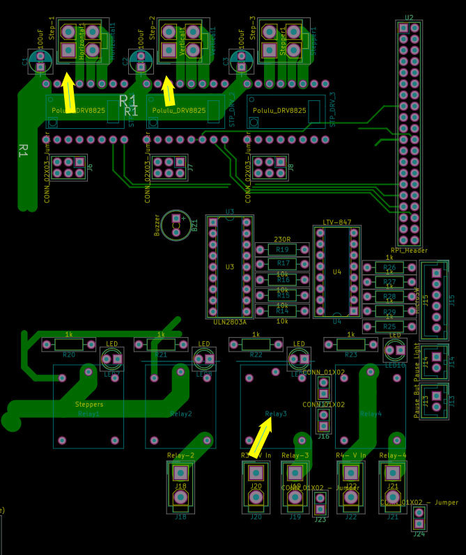

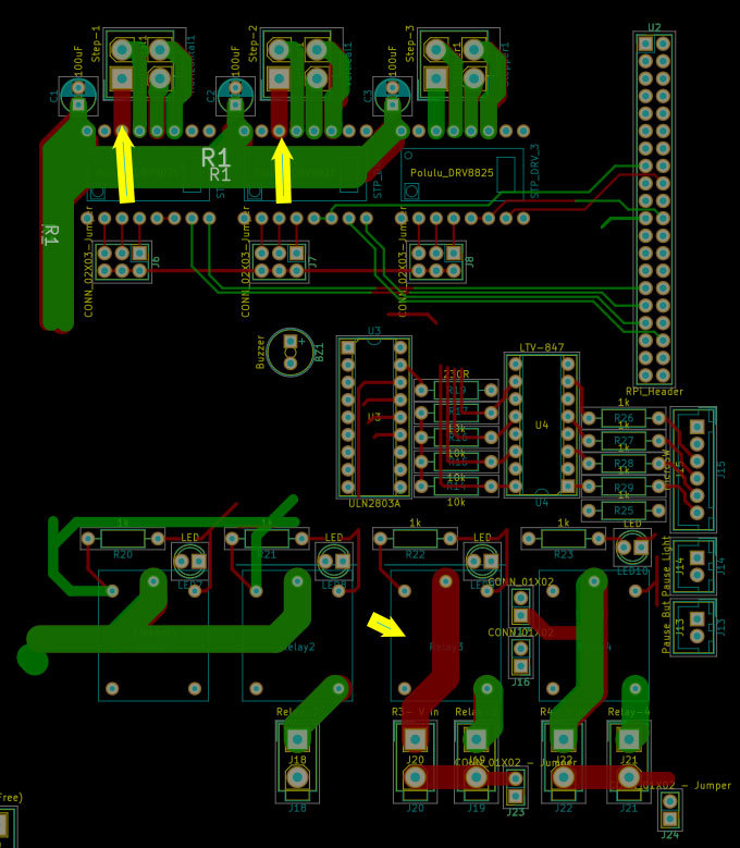

Hi I’m having the same issue.
I am working on a 2 layer board and every time I overlay a track, the track I am covering disappears. I have switched between all modes (Default, OpenGL and Cairo) and it still occurs. It’s strange b/c I was able to overlay a number of tracks initially…
I can only post 1 image at a time so will show with 3 posts.
Thanks
Adam
F Layer
B layer

I toggled it and tried a few times in each state. I still get the same result. Also tried in the different views. My trace still disappears…
