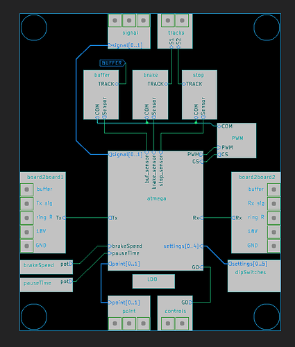

So I need/want one single 8 pole connector. My current workaround to achieve this, is to create a sheet, XYZ, give it the 8P screw terminal and then use hierarchial sheet labels to connect the dots (connections).

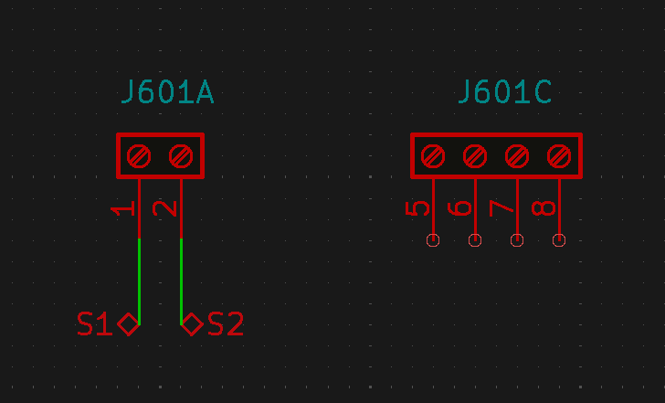

I was thinking. To actually achieve this, you need to edit one single symbol. So I did. Here you see the A and C unit. And the B unit is 2P and is currently in a different sheet somewhere else.
Though it is somewhat actually workable, it is a little bit cumbersome to achieve. In this particular case I had to manually change some graphics of the 4 pole variant. I had to copy paste the 2P scew terminal, and merge the red squares. And you need to manually fix the pin numbers ofcourse.
What if, and bare with me, we get to have one whole generic “special“ symbol. Where I can do just this, but simpler. That you can modify really quick and really simpel. You just tell, how many units it has and how much connection each unit has. Than the graphics and pin count/numbering would be made for you, for that one single symbol.

I just did an experiment just to know how much work it is to create a custom connector, and I basically did the same as:
In more detail:
  1. Create new symbol in a writable library.
  2. Copy a 2p screw connector into it.
  3. Symbol Editor / File / Symbol Properties / General / Nnumber of units (Also uncheck the “All units are interchangeable” checkbox.
  4. In the gui, set the unit to another one.
  5. Copy a pin (and the “screw”) and paste it (or a bigger block to do more pins at once).
  6. Select the graphic rectangle and stretch it to the required size.
  7. Symbol Editor / Edit / Pin Table to modify the pin numbers.
Together it’s just a few minutes of work, thanks to the ease and capabilities of KiCad’s symbol editor. I don’t think it’s worth it to further automate this. Automation also has it’s own drawbacks. It needs extra work for different types of connectors (symbols) and it needs it’s own user interface.
Why would you do this? Don’t you think it is easier than to take some random connector symbol, and simply click ‘edit symbol’ in the properties menu? It will be a project specific thing. Does not have to end up in some library, right?
The rest of the steps is about the same as I did. Only step 7 I don’t follow. I just open the editor for the symbol. Select the amount of units, copy paste things, correct graphics and I alter the pin numbers right away when I am at it.
