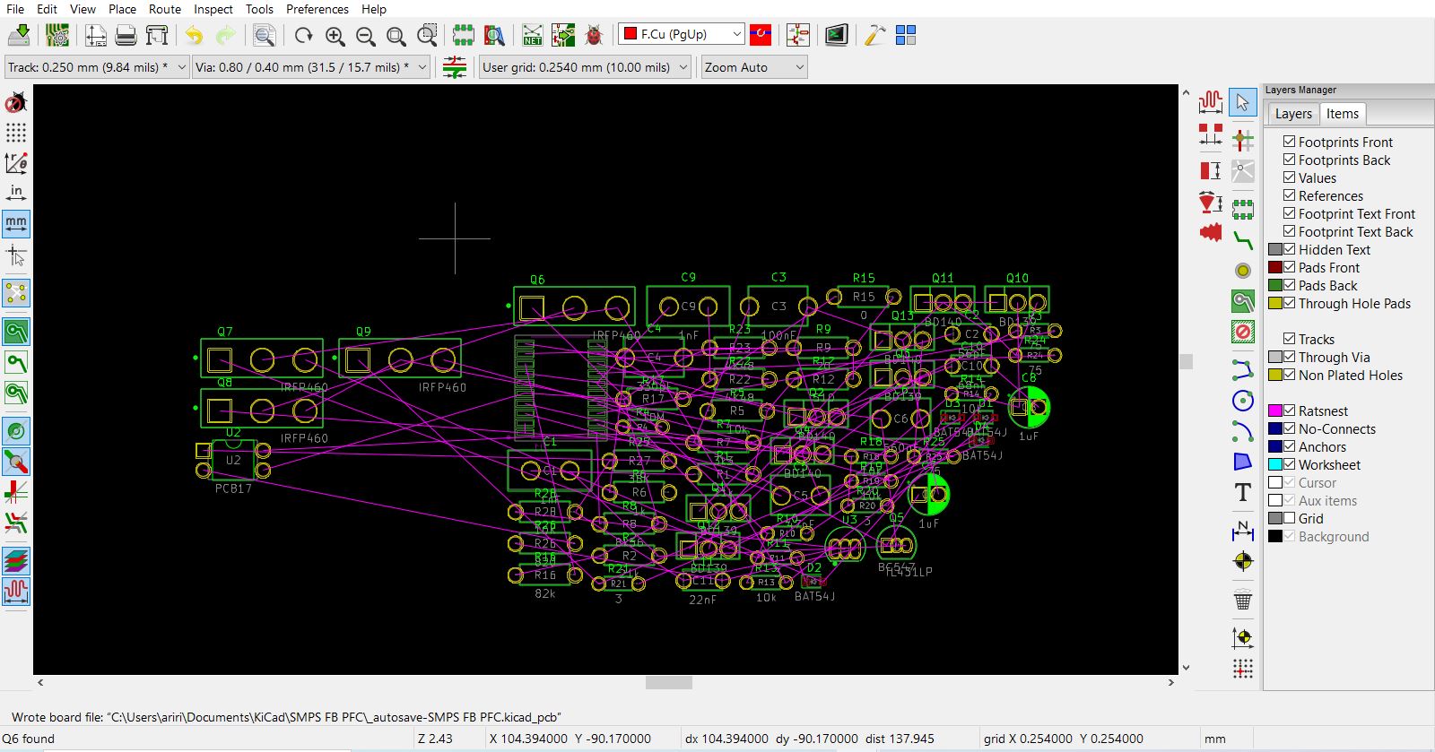

Nothing the pads on the display
how to solve this problem? the pads not showing for all component.
Eeschema / View / Drawing Mode / Sketch Pads
Or learn to work with the icons on the left side of your screen:
You can also turn off Eeschema / View / Show Microwave Toolbar You probably don’t need that and it makes the working area a bit bigger.
When you click the UPDATE PCB from Schematic (just to the left of the BUG), it will read the schematic and import all the assigned footprints. At that time, it will show a list of symbols which do NOT have a footprint assigned. Please have a look at that list.
In EEschema, click on the icon just to the RIGHT of the BUG and you will see the list of symbols and footprints. Make sure all symbols have a footprint assigned…

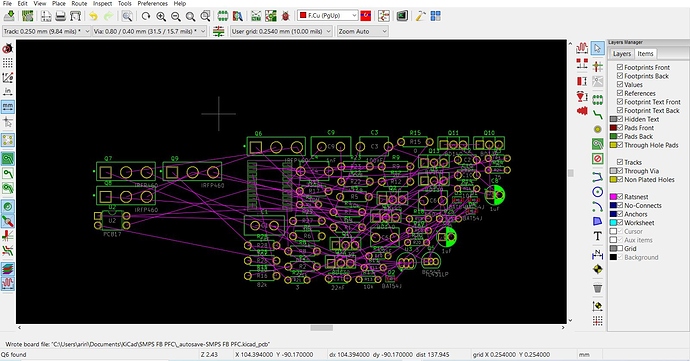

Nice, thank you. Just clik circle icon (show pads in outline mode) on the left side.
