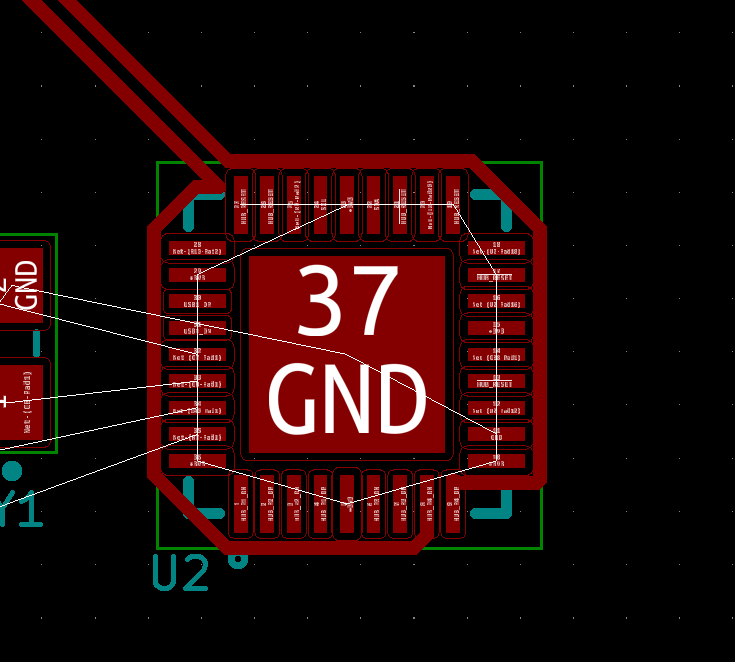

Not able to route the differential pair as in drag and rout
I’m using KiCAD 5.1.5, I’m not able to route the differential pair properly the way I wish I mean click and route. If you look at the DIFFPAIR image and when i try to change direction by clicking it just doesn’t allow me to ( as you can see in other two images - DIFFPAIR1&2)

Check your net clearances. The grey area around your trace indicates the required clearance. It looks like it is set to a larger value than your diffpair separation. So either increase the diffpair separation or decrease the clearance (for the later make sure the fab can still produce your board if you decrease the clearance.)
General remark: KiCads interactive router does not really rely on you doing such micro management task as clicking to change direction. Click on the start point, move your mouse approximately along the route you want the trace to go and click on the endpoint.
If you want such fine-grained control then switch the router to highlight collision instead of walk around.

Do you mean a sharp 90° turn? You can deactivate the addition of a 45° section in the router settings.
Maybe this will make it clearer. Here I am just trying to exit the pads and move to the right. It requires several clicks to guide the router. Clearly there is a feasible path though, it seems pretty braindead that KiCAD can’t get from here to there.
Also, it seems like the router prefers to hug existing objects (I suppose this minimizes waste of clearance). But that’s not my aesthetic preference, and sometimes leads to lovely solutions like this:
And of course in pretty much every situation I need to manually guide pad connections or get garbage like pictured.
