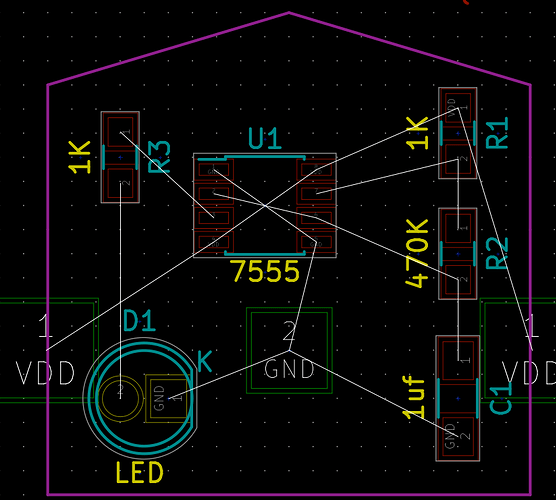

I’ve got a really dumb new question. I’m making a pcb layout and I can’t make the traces. My pads are hollow like this and I can’t make connections ->
I have no idea why I can’t make traces. I think I have something switched off but my knowledge is so limited, I don’t even know what to search for.
Tips really appreciated.

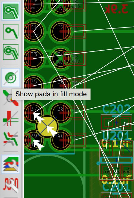

The pads being hollow is a view option toggled by the highlighted button on the left:
Drawing traces should be possible with the “add tracks” button or “route>single track” menu option since we can see the ratsnest.
Hover your mouse over all the left and right menu items, and you can see what they do.
There is an icon on the left, for Pads as outlines/filled
There is an icon on the right called add tracks and vias, if you select that, do things change ?
You’ll probably want the Shove router : Switch view to OpenGL and Preferences.Interactive Routing to Shove()
