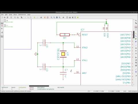

how do I link them ? I can load the device in eeschema, but how do I specify which footprint to load for the PC Board ?
Actually just found this video:
around 9 minutes in seems to be the solution ?
