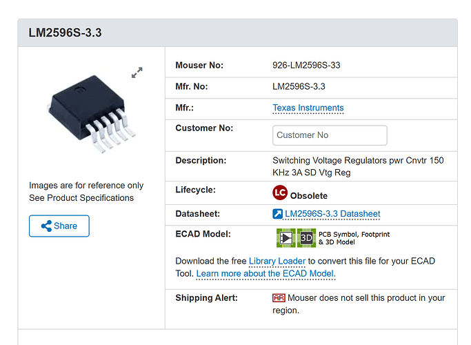

And its an obsolete component . . . but lets not split hairs :wink:

Source? (of that info).
I see no indication of this @ti:
Digikey has around 70 variants of the LM2596 on stock, maybe just some variants are deemed to be(come) obsolete?

Maybe its the non lead free version I found . . .
Sorry i don’t understand, which SVR component should i use?
What is an SVR?
I do not believe in obsolescence for the LM2596 any time soon. Some specific variants may go out of production, but there are plenty of others left. Mouser (as indicated by Raptor) sells them from both Ti and Onsemi. On LCSC, you see them from TWGMC, UMW, HGSEMI, GR, HANCHIP and probably more, but I stopped scrolling down the list. (The list is 182 items long.)
