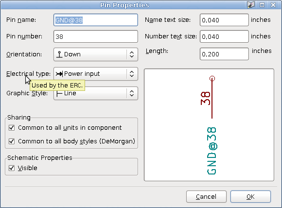

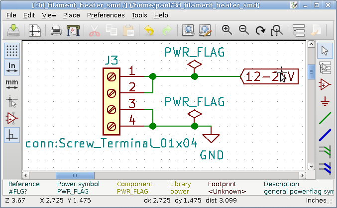

Mine (a very simple project with ESP32 MPU) have two ERC errors and everything I am doing results in errors.
I have all day with this problem. It has something to do with power lines.
In another project it is working OK but not here.
Can you please see where the problem is and I have two ERC errors.
I will greatly appreciated. So to move on because I just stack all day with this silly error.

First: You should not have posted / hijacked this thread.
You should read up on the use of the PWR_FLAG symbol:
http://docs.kicad.org/stable/en/eeschema.html#wires-buses-labels-power-ports
I had a peek at your schematic, and it seems that there is no input connector for the 12V-24V.
So I added a connector, and added the proper power flags to indicate where the power comes from:
Screenshot_2018-05-26_03-17-54_PWR_FLAG
After that the 2 ERC errors were gone, but another popped up from pin 38 of ESP32-DEVKITC.
Hover above the ESP32 and press [CTRL + E], then edit pin 38 in the library editor and set it’s properties to power input instead of bidirectional.
Screenshot_2018-05-26_03-22-18_ESP32
Then I can run ERC without any errors.
You should also set the other power pins of your ESP32 to power input.
