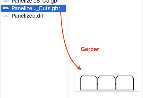

Hello Everyone,
I’m recently very new to the pcb designing aspect and community. I more or less just have a few ideas that I would like to try and create into pcbs. I started with my basic simplest build as a crash course. I’m wanting to make this project to where I can print 3 of each of my 2 boards in one order for prototyping to get my monies worth when getting them made. I have watched a few videos but I’m having problems getting my lines to match up when doing the drgs.user with the 2mm mousebites. Is there any way to get my pcb centered on one of the grid points? Or is there an easier way to do this?

Below screenshot was from PCB123 and had no problem panelizing for me at no extra cost.
To make a ‘Panelize-able’ board:
  1. Know or estimate/ask-fab-house how they cut boards (Laser, Mill, Waterjet…) and what the width of ‘Kerf’ is.
  2. Ask if there’s a preference for what Layer the PCB shape/profile needs to be on.
  3. In KiCad, Board Settings, set the Line-Width to be same as the Kerf width
That will yield a fairly accurate finalized board.
Example below:
•The board shape (wide red lines )is on the Edge-Cuts layer. I Mill my boards and use a 1mm EndMill, thus, lines are set to 1mm.
•Set the Grid to reflect how KiCad snaps to stuff such that (along with the parts) the Cut lines are centered on the snap points.
•Gerbers loaded into CopperCam with a EndMill or Laser as the cutting tool, cutting on outer-edges.
•Preliminary and Final Results shown.

I have tried two methods. You can read about my experience and follow the links with V-cut here:
JLCPCB will also do V-cut. It’s free if there is only one design on the panel. You have to indicate it in the order, usually there’s a “Customer panelization” option to tick.
You can read about my experience with breaktab and mousebites, and follow the link to a discussion of GerberPanelizer, the software mentioned by @Shack here:
